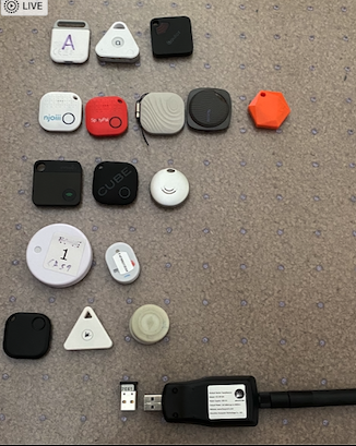

picture of almost all newly tested beacons:
1. row: aiko, ihere, Smart_tracker
2. row: Njoiii_iTrack, SpotyPal, NutFind 3, Nutale, xy3
3. row: Innway, Cube, Orbit
4. row: ruuviTag, myBlueT
5. row BlueCharm, Feasy_Triangle, Feasy_USB,Radius
6. row: Radius-USB, Feasy_USB

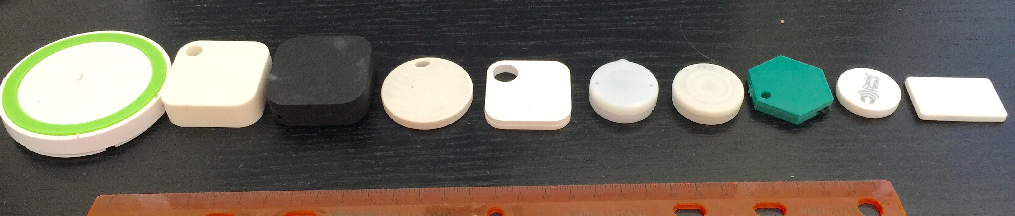

attached picture of all tested iBeacons.. from left to right:
Sanwo, Jaalee 03, 04, pebbleBee, Tile, JO-BEC05, radius, xy, social retail round & square
and social retail C1 twice as big as the large green one:

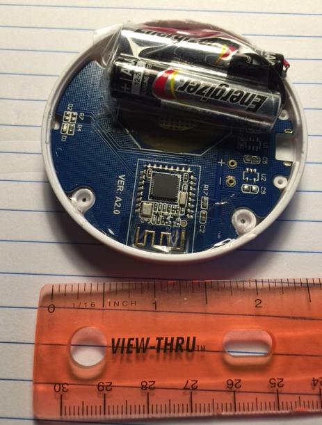

replacing a lithium battery with 2 AAA batteries:
I used the big green iBeacon from Sanwo, after the build-in Li battery was dead to replace it with 2 simple AAA.
It is straight forward, if you can solder a bit:
2 of the battery ends go together ( one + and one -)
and the other 2 + to + and - to - at the proper places on the board, wrap it with some scotch tape and you have an iBeacon that last > 2 years.
Naturally it does not fit into the old cover, but this is one for your car . You could hide in the glove box. It is not pretty. But works.
