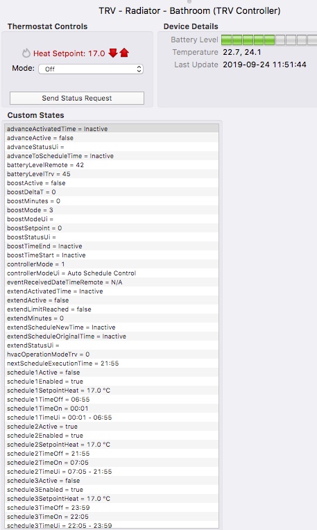

A question for Autolog....
I am trying to setup a Control Page that indicates which TRV is requesting Heat.
i.e. when the TRV demands heat it, on my setup, changes the Variable HeatingDemand to true.
All well and good but I would like to display which specific TRV is requesting that.
In the Device the fire icon illuminates when Demand is required in the Device Details (but not in the main display)
Which Custom State is that or what attribute is that so I can trap it?
[edit] is it possibly HVACOperationsModeTRV - 1 being Demand True, 0 being Demand False?

Busta999 wrote:A question for Autolog....
Try Heater Equipment State (on or off) - it is a predefined Indigo Thermostat State (about 14 down from the top of the state list) when you select the TRV Thermostat Device (the plugin device not the Spirit) as a device state in the Control Panel. :)

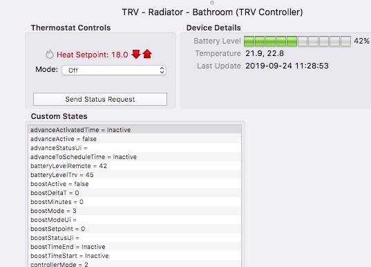

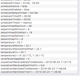

Busta999
Posts: 714
Location: Wales UK
Post by Busta999 »
Autolog,
I am missing something here.. I cannot find Heater Equipment State in the state list - is possibly because my TRV devices call for heat through a variable change rather than directly control a device?
What am I missing ?
BTW - it appears that HVACOperationsModeTRV does reflect Demand as well - or have I completely lost the plot - not out of the question :-)
Indigo - TRV States 1.jpeg (112.8 KiB) Viewed 3541 times
Indigo - TRV States 2.jpeg (48.83 KiB) Viewed 3541 times
autolog
Posts: 4077
Location: West Sussex, UK
Post by autolog »
Busta999 wrote:Autolog,
What am I missing ? ...
You are looking at the custom states on a device on the Devices page.
I inadvertently cause confusion by referring to a Control Panel - I'll blame auto-correct. :wink:
I meant to refer to the state list for a device defined on a Control Page - just checked again, it is there. :)
If you want to refer to the actual state name then it is heatIsOn which will have a boolean state of True or False
HVACOperationsModeTRV reflects whether the device is in Off or Heat mode. It can be in Heat Mode but not calling for heat if the ambient temperature is less than the Setpoint.

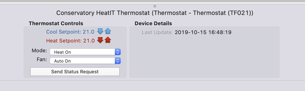

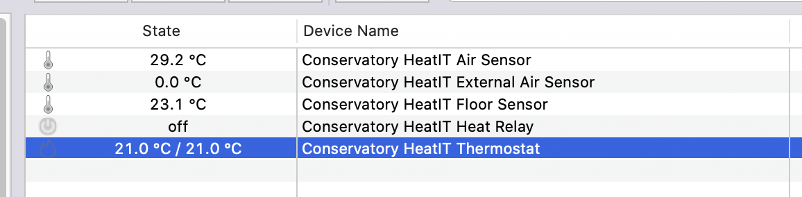

First of all - awesome plugin, using a lot.
With the latest FW (and updated Indigo support) for the floor thermostat you already added (HeatIT TF021), it is not possible to use the plugin anymore.
Per Matt, he had to add some specific "hacks" to show the temperature properly from multiple sensors.
Is it possible to update? I'm using the TRV plugin to control all heating in the house, except the Floor in the conservatory :)
TRV Error StandardError detected in TRV Plugin [zwaveCommandSent]. Line '655' has error=''zwaveSentCountTrv''
Z-Wave received "Conservatory HeatIT Thermostat" mode is heat
TRV Error StandardError detected in TRV Plugin [zwaveCommandReceived]. Line '498' has error=''zwaveReceivedCountTrv''
Z-Wave received "Conservatory HeatIT Thermostat" heat setpoint is 21.0 °C
Z-Wave received "Conservatory HeatIT Thermostat" cool setpoint is 21.0 °C
Z-Wave received "Conservatory HeatIT Air Sensor" sensor update to 29.2 °C
Z-Wave received "Conservatory HeatIT External Air Sensor" sensor update to 0.0 °C
Z-Wave received "Conservatory HeatIT Floor Sensor" sensor update to 23.1 °C
Screenshot 2019-10-15 16.57.04.png (98.59 KiB) Viewed 3408 times
Screenshot 2019-10-15 16.56.59.png (144.6 KiB) Viewed 3408 times
Screenshot 2019-10-15 16.56.41.png (144.19 KiB) Viewed 3408 times
autolog
Posts: 4077
Post by autolog »
Looking at the code, I can't see how that error can happen but obviously it can! :?
I hope I have added a work-around for this error but I don't have a device to test with.
You can access the potential work-around fix here: TRV Controller - Pre-Release Version 1.3.3
Let me know what happens - it may need more work. :)
shapa
Posts: 483
Location: Swindon
Post by shapa »

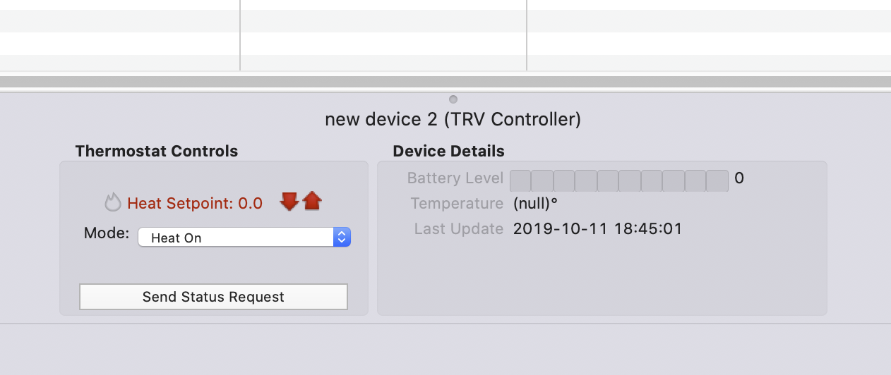

OK, now I'm seeing (at the start)
TRV Error StandardError detected in TRV Plugin [deviceStartComm of device 'Conservatory TRV']. Line '3100' has error='list index out of range'
When trying to update the device (virtual TRV) status
TRV Error StandardError detected in TRV Plugin [zwaveCommandSent]. Line '726' has error=''zwavePendingHvac''
Z-Wave sent "Conservatory HeatIT Thermostat" mode status request
TRV Error StandardError detected in TRV Plugin [zwaveCommandReceived]. Line '505' has error=''zwaveWakeupIntervalTrv''
TRV Error StandardError detected in TRV Plugin [zwaveCommandSent]. Line '684' has error=''zwavePendingTrvSetpointFlag''
Z-Wave sent "Conservatory HeatIT Thermostat" heat setpoint status request
Z-Wave sent "Conservatory HeatIT Thermostat" cool setpoint status request
and while trying to update settings
"You must select a TRV device to monitor which is known by the plugin; a 'Thermostat (TF021)' is not a TRV known by the plugin."
autolog
Posts: 4077
Post by autolog »
Try this version: TRV Controller - Pre-Release Version 1.3.4
I have added in a model definition (which may need to be tweaked) so the plugin knows about the thermostat. :)
Return to “TRV Controller”
