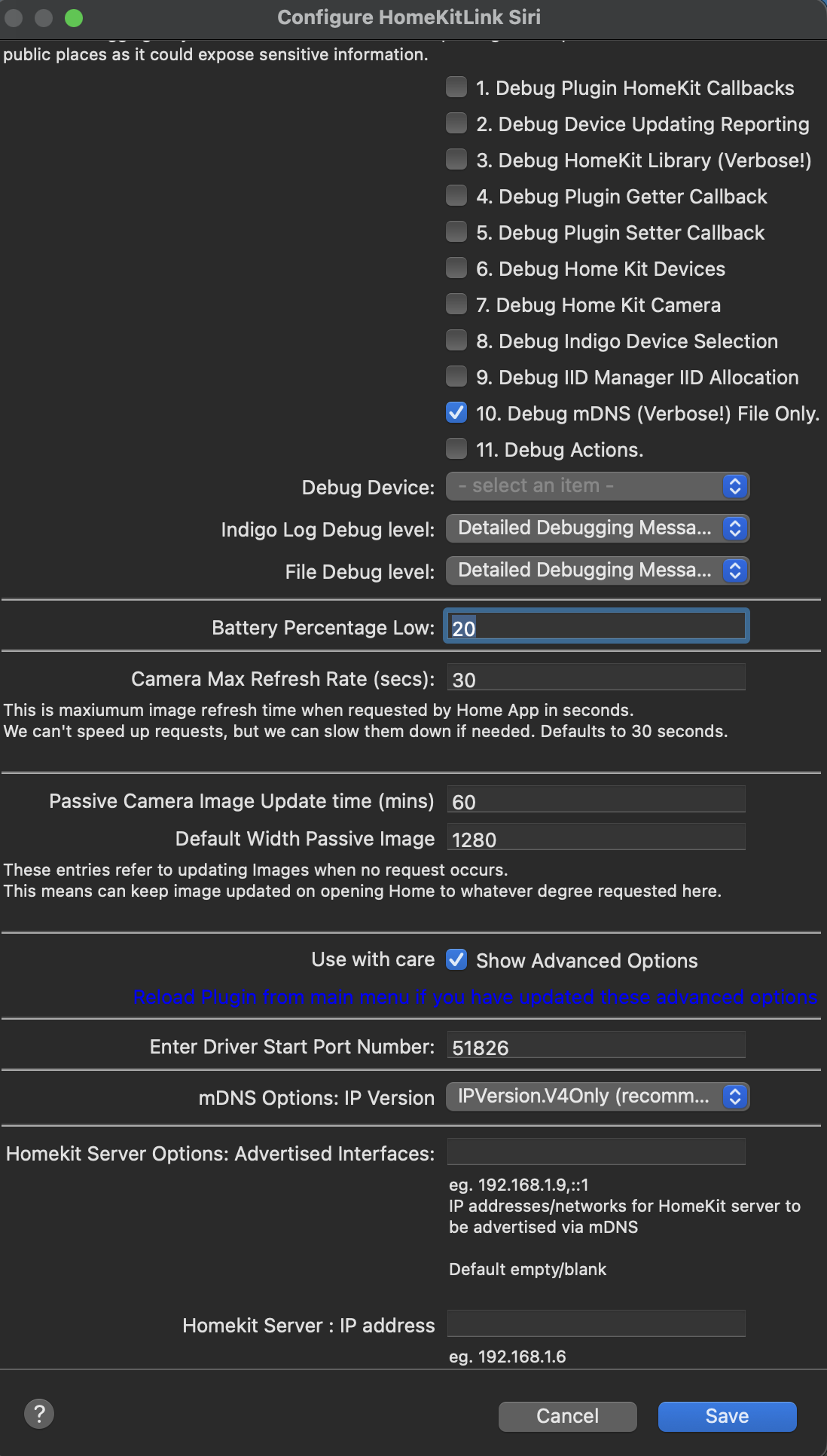

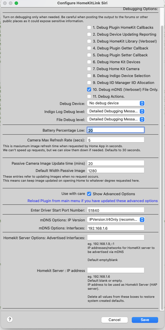

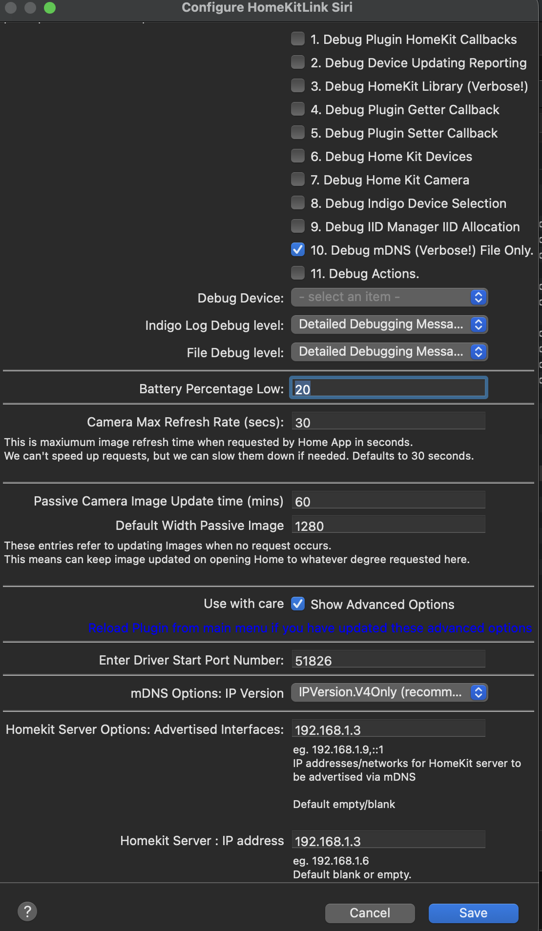

Change to IVP v4ONLY -- all the logging here is for IVVersion.ALL
The issue here:
Their output proves the “bad” state is:
Indigo plugin bound to IPv6 UDP/5353
attempting IPv6 multicast (ff02::fb)
failing to route it → advert expires/removes
This is my output:
 sudo lsof -i UDP:5353
COMMAND     PID           USER   FD   TYPE             DEVICE SIZE/OFF NODE NAME
mDNSRespo   197 _mdnsresponder    6u  IPv4 0x45c2617ff8173b16      0t0  UDP *:mdns
mDNSRespo   197 _mdnsresponder    7u  IPv6 0x6ed618d0c6176c29      0t0  UDP *:mdns
IndigoPlu 13955     indigohome   10u  IPv4 0x14a66e5e8c59313f      0t0  UDP *:mdns
IndigoPlu 13955     indigohome   11u  IPv4 0x755cde5643da3d45      0t0  UDP localhost:mdns
IndigoPlu 13955     indigohome   12u  IPv4 0x7bd9462aa81db2d4      0t0  UDP 192.168.1.6:mdns
IndigoPlu 13955     indigohome   13u  IPv4 0x2ba57351f556b182      0t0  UDP 192.168.1.155:mdns
IndigoPlu 56241     indigohome   14u  IPv4 0xec1f23b6b74f780a      0t0  UDP *:mdns
IndigoPlu 56241     indigohome   16u  IPv4 0x19e220e665169e18      0t0  UDP 192.168.1.6:mdns
IndigoPlu 56241     indigohome   17u  IPv4 0x660e7131285358cb      0t0  UDP localhost:mdns
indigohome@Indigo-Middle-i7-Mac-Mini ~ %
You'll note no IVP6 anywhere - the HAP library needs IVP4 to work.
All the logging here is for IVPVersion.ALL and probably is defaulting to IVP6
Need to restart after applying these advanced settings.
Delete the IP address in the entries in the pluginconfig - make sure blank.
Delete the file plugin.log in file directory.
Restart the plugin
Try again.
Post the log.

Not sure if I was supposed to disable the other DEBUG boxes besides mDNS like in your picture, but I did so.

- And debug selection - Picture was for the yellow box - but mDNS only.should be okay. File on debug logging.

OK that's what I'll look for going forward... any changes we make, if it were to make a difference, would be to get that advertisement to show if of 6 instead of 1.
Added IP address 192.168.1.3 to both IP fields as per the screenshot. Advertisement is still on if 1 and thankfully continues to stay advertised.
Unfortunately adding Bridge as Accessory is still failing (as you pointed out, probably because Advertisement is still on if 1).
Captured event.log (renamed to event 20h36m.txt) and plugin.log (renamed to plugin 20h36m.log) so that if downloaded you're looking at the correct file (perhaps the same name file when downloaded has been renamed so you end up with plugin 2.log?)
Screenshot to confirm the Advanced settings and logs attached.
