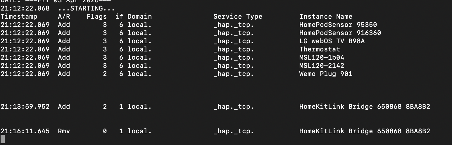

Here's the screenshot of the mDNS advertisement showing up and then the Rmv being issued. I'm not sure what is causing it, but it is consistently happening now with everything I've tried above. The plugin re/starts and the mDNS advertisement shows up, and then when I go to Home to add the Bridge Accessory via the QR code, during the adding process the Rmv causes the advertisement to go away and I have to restart the plugin for it to show up again. Note, the "Add to Home" never successfully completes.
Here's the screenshot of that:

The output of the mDNS advertising was as follows:
unifi:~ jaymoo$ dns-sd -B _hap._tcp
Browsing for _hap._tcp
DATE: ---Sat 04 Apr 2026---
16:55:14.533 ...STARTING...
Timestamp A/R Flags if Domain Service Type Instance Name
16:55:14.534 Add 3 6 local. _hap._tcp. Thermostat
16:55:14.534 Add 3 6 local. _hap._tcp. LG webOS TV B98A
16:55:14.534 Add 3 6 local. _hap._tcp. HomePodSensor 916360
16:55:14.534 Add 3 6 local. _hap._tcp. HomePodSensor 95350
16:55:14.534 Add 3 6 local. _hap._tcp. MSL120-1b04
16:55:14.534 Add 3 6 local. _hap._tcp. Wemo Plug 901
16:55:14.534 Add 3 6 local. _hap._tcp. MSL120-2142
16:55:14.534 Add 2 1 local. _hap._tcp. HomeKitLink Bridge 186124 3BF073
16:56:11.621 Rmv 0 1 local. _hap._tcp. HomeKitLink Bridge 186124 3BF073
That is the totality of the output from the DEBUG setting in the Event Log. Is there another flag I need to enable to show more information?
As you can see by the timestamps, the bonjour advertisement existed until the Rmv. When the Rmv event occurred, there was no additional logging that happened in the Event Log. Indigo still thinks the Plugin is working (shown as operational) but no longer advertised in bonjour.
I noticed today that the Rmv will come out within a couple of minutes of starting the Plugin, even if I don't try to add the Bridge.
Ready to try more debugging steps!

onlyjaymoo
Posts: 24
Joined: Fri Nov 25, 2011 4:07 pm
Re: HKLS Troubleshooting on OS 26.4
Post by onlyjaymoo »
OK, I see what you're seeing -- and thank you for the information on the mDNS "keep alive" timeout, that makes a lot of sense. So it is basically "auto-removing" itself because it's not receiving the keep-alive after 120s.
I changed to IPv4Only, and added 192.168.1.3 to both the advertisement field and the server IP field.
However, after saving and restarting, it didn't seem to make any difference, it is still trying to use IPv6. I even stop/start Indigo to see if that would make a difference.
I also explicitly turned off IPv6 on the Ethernet interface (using: networksetup -setv6off "Ethernet") just in case it was using some kind of auto-detection to determine if it should use IPv6. Here are the timestamps of the most recent attempts:
21:55:54.713  ...STARTING...
21:55:54.714  Add        3   6 local.               _hap._tcp.           HomePodSensor 95350
21:55:54.714  Add        3   6 local.               _hap._tcp.           Thermostat
21:55:54.714  Add        3   6 local.               _hap._tcp.           HomePodSensor 916360
21:55:54.714  Add        3   6 local.               _hap._tcp.           MSL120-1b04
21:55:54.714  Add        3   6 local.               _hap._tcp.           Wemo Plug 901
21:55:54.714  Add        2   6 local.               _hap._tcp.           MSL120-2142
21:56:03.078  Add        2   1 local.               _hap._tcp.           HomeKitLink Bridge 186124 3BF073
21:58:13.998  Rmv        0   1 local.               _hap._tcp.           HomeKitLink Bridge 186124 3BF073
Attached is the latest plugin.log, truncated to when the 21:56 HKLS restart happened after changing the settings above.
*Note: Despite the settings, I see that IPVersion.V6Only is still being used when zeroconf.new_socket is emitting its debug message.
plugin.log
(92.5 KiB) Downloaded 16 times

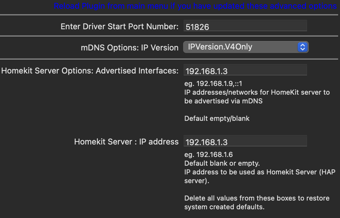

Also, just so you can see I have the settings in place, attached is the screenshot of the configuration.
Screenshot 2026-04-04 at 10.47.28 PM.png (114.44 KiB) Viewed 204 times
GlennNZ
Posts: 1873
Post by GlennNZ »
See my above post
But need to restart plugin for these settings to take effect

-- Right now, based on these settings, I can't get the mDNS to show up anymore. I will try to see what combination of things gets at least the initial advertisement to come up after restart.
onlyjaymoo
Posts: 24
So, despite me resetting everything back to default (IPVersions All, blank for both IP address fields), I can no longer see the initial advertisement.
Looking at the latest logs (attached), it seems that the setting for the plugin is indeed IPVersions All, but zeroconf is using v6only for some reason.
Also looking at the interfaces report, 192.168.1.3 does support multicast.

The log reset (it's midnight here), so I decided to do a complete reboot of the Mac with all of the forced settings in place (v4Only, IP address in both fields)
It looks like the changes took, based on what's in the logs. And it's clean (I don't see any errors).
BUT, the advertisement is not showing up... even the initial mDNS that we used to get before doesn't show up anymore.
Perhaps that has been the issue all along, but that's where we are at the moment. Here is the fresh log:
