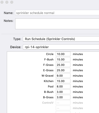

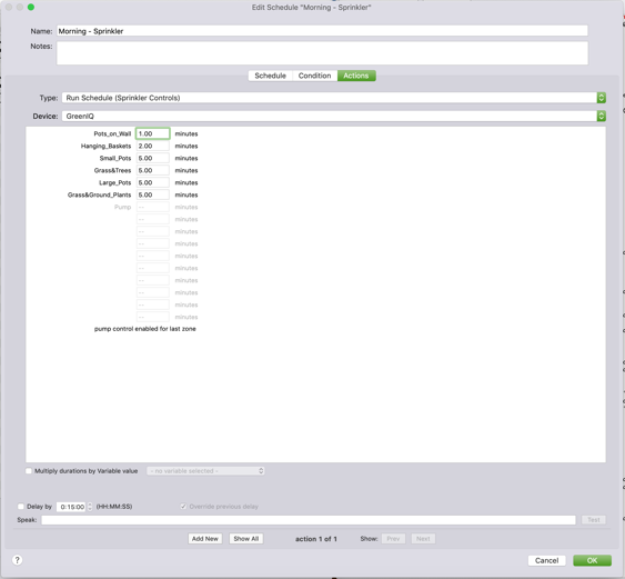

So this is my config of the Sprinkle And Schedule Action:
It does seem that it takes so long to send the command that using the Action "Run Schedule" does nothing as the amount of time I run each zone for is less than the time it must take to actually action the command on the Pi.
I can see the action sequentially triggering each zone according to the scedule but nothing actually happens. Valves to not get triggered and master pump does not get turned on.
If i turn on the zone from indigo gui, it will eventually start the pump and open the valve but it does take many mins. If i do the same via OUTPUY-GPIO-1-On/Off then it takes seconds to turn the GPIO on or Off.
- Schedule Action
- Screenshot 2019-05-06 at 16.58.33.png (47.11 KiB) Viewed 3279 times
- Config
- Screenshot 2019-05-06 at 16.37.00.png (51.43 KiB) Viewed 3279 times

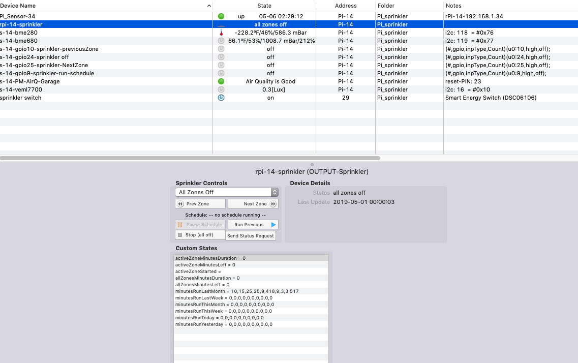

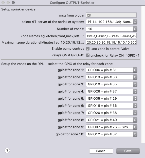

here my dev config and my action ...
don't see anything wrong. if you "manually" run a zone in the sprinkler device (run schedule or next zone). how long does it take.. mine takes < 1 secs to start.
could you enable debug "output" and check when the command gets send - ie time stamp .. in the logfile. (or just double click the logfile ) (in ... indigo 7 x/Logs/pibeacon../plugin.log if you use one of the latest versions .
Ps one of my temp sensor is bad (-228F)
have not run anything in the last weeks as we had plenty of rain > 15 cm, but I tried to run just now and it works fine ..
