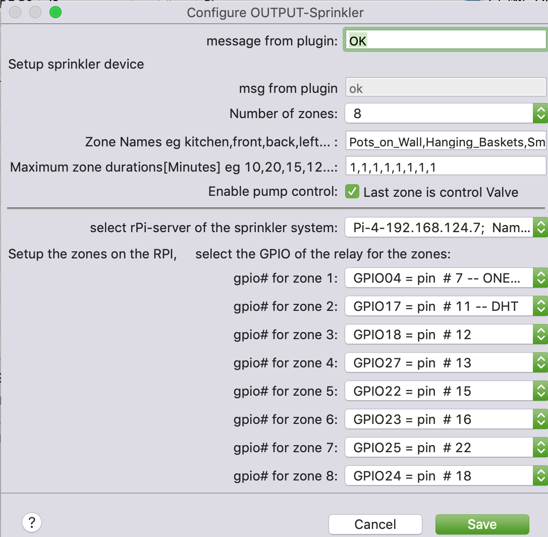

I can turn on GPIO 24 from command line then any Zone 1 - 6 fine from CLI on or off but having configured these GPIOs in PiBeacon Sprinkler, it takes a while then ALL Valves are turned on.
I have Enable Pump Control enabled as I assume this mean that the pump is turned on when any other valve is activated but at the moment I am having issues.. I am assuming i need to configure the GPIO pins as this is a Model B with a 26 pin header not 40 pin. In the gui GPIO 04 is labelled one wire and GPIO 17 as DHT. I assume i need to set these all to be output.

Re: GreenIQ - Model B - Irrigation and PiBeacon
The one wire etc are just comments. But YOU NEED TO DISABLE ONEWIRE in sudo raspi-config
Also is the relay ON when gpio is low or high ?
I am out of town but I remember that the should be an option to set that.
It should work fine with a rpi1
There is very little load by pibeacon on the rpi
Running a display might tax it a little but not too much.
Karl.

Hmm so if i press "Send Status Request" it turns on all valves...
Is high and low on these GPIO reversed do you think? Just lookin at Sticky 6 and it says:
change the display state column value:
The indigo state values of the GPIO input pins are
1 = GPIO input connected to ground
0 = GPIO open or high
if you want to inverse this for the display state value: set offset to -1 and multiplier to -1 in device INPUT edit that will do
0 = GPIO input connected to ground
1 = GPIO open or high
but only for the display state column not for the other states.
Trying to figure out how to inverse these GPIO Outputs. and if it can be done? I may have the wrong end of the stick here so thanks for bearing with me and helping.
Again I can not look at the code. But what you mention is just for display in indigo state column

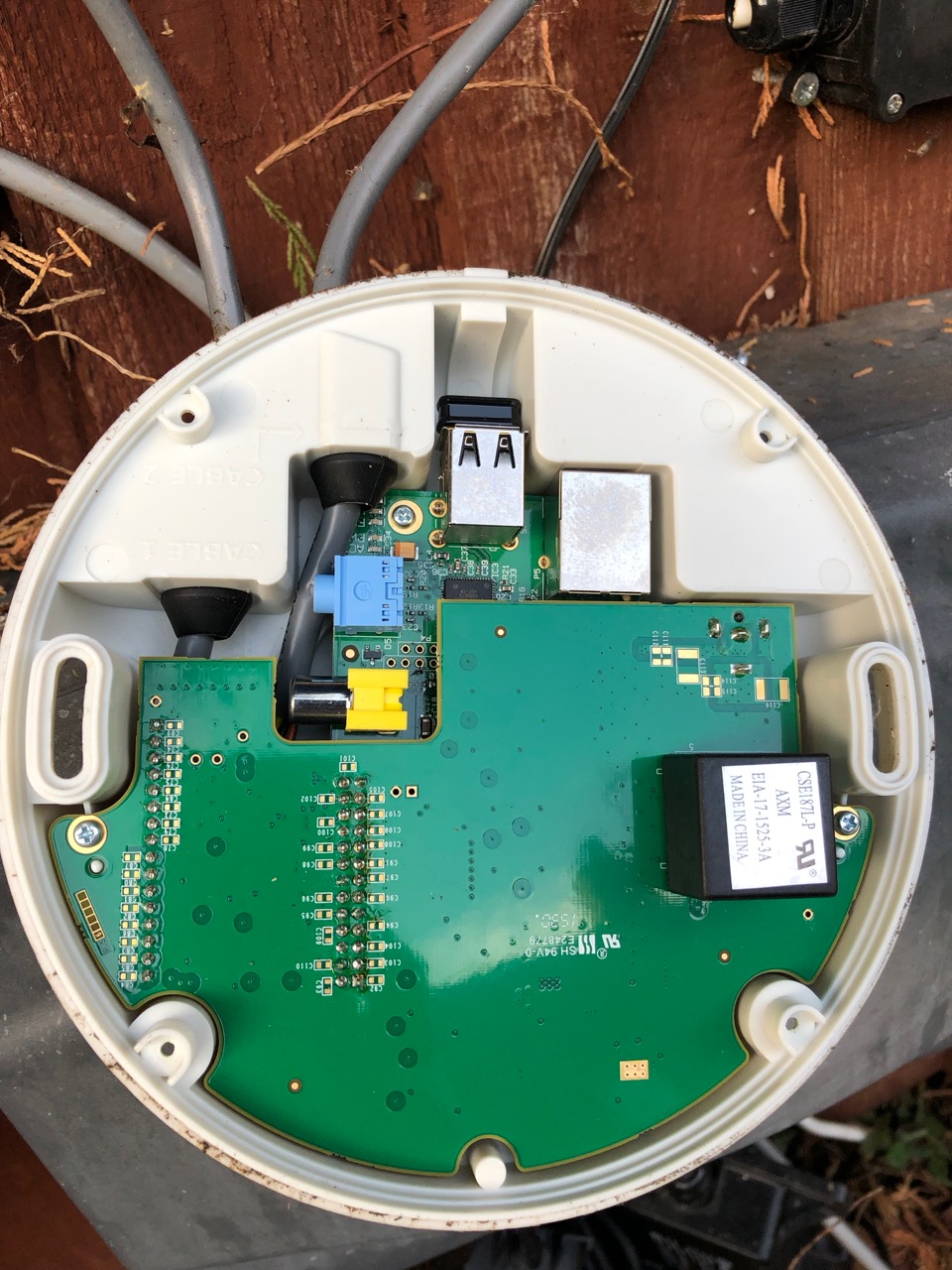

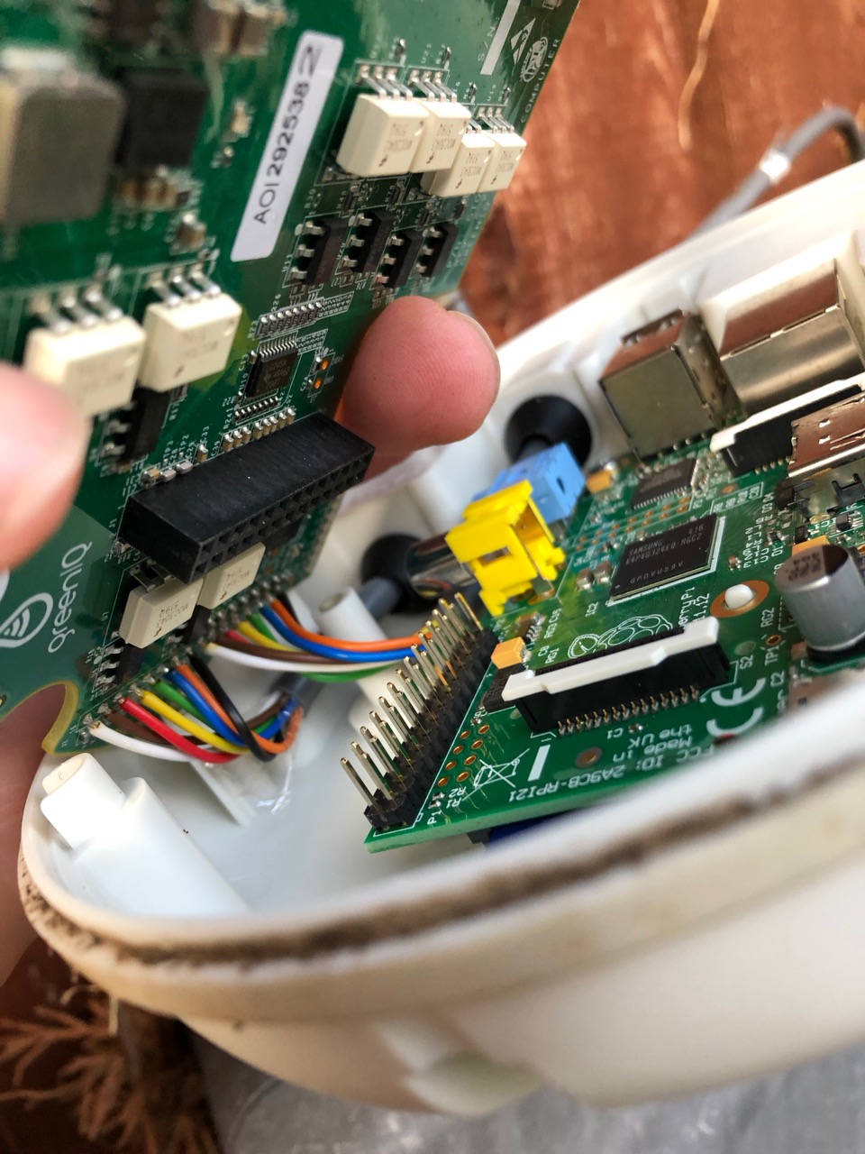

Photos when opened to replace SD card and add Bluetooth Module.
I am not sure this uses relays as all the relays I have seen are much larger than any surface mounted chip that can be seen. The White chips seem to have a lowercase "f" which looks like the manufacturer and "M005044 519Q" written on them. I assume this are optoisolators?
The transformer is a CSE187L-P which is on the rear of the board.
Ill give the gpio -g commands ago in the morning as its too dark to see which zone is on or not.
