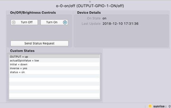

I am now following the up/down high/low through each step and have cleaned up some programming.. many places to look...
this is roughly the flow
action --> get dev defs --> send to RPI -> receive at RPI --> set GPIO --> send "actual value" back to plugin --> receive in plugin --> put into dev/state
will post a new version later today ..
will have this
Screen Shot 2018-12-10 at 17.40.05.png (29.85 KiB) Viewed 6561 times

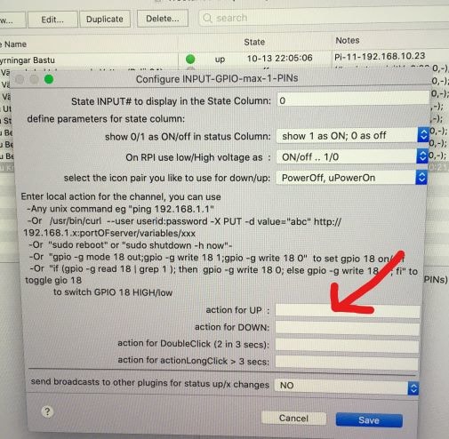

Hi Karl,
I would like some help to send one pulse to an output when an input becomes high (Action for UP). For example, high for 5 seconds.
It is possible?
/Sam
Re: Input toggles output in Raspberry
you can insert a sleep xx:
gpio -g write 21 1;sleep 5;gpio -g write 21 0
for gpio21 (still need to add the mode ... stuff infront)
ps
you can do
ssh pi@xxxx
then try any command = play with them, see what works..
gpio -g mode 18  out;gpio -g write 18 1; sleep 3 ; gpio-g write 18 0
if you like it, copy that whole line w/o the new line and paste into the command field action up / down ... in indigo device edit.
psps: here the manual for the gpio commands:
http://wiringpi.com/the-gpio-utility/
