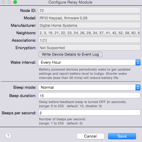

mat wrote:Has anyone got the beep working? ie beep for 30 seconds before the alarm arms when away is set?
Ok, I've read up on this and can do it.
When you edit your Zipato's devices, has Matt exposed parameter 2 and 3 in the UI for you? (Notification timer/timeout and acknowledgment timer/timeout)
I still need to code in the actual commands to sound the alarm, but I need to know whether to provide a UI for the above parameters or not.

This is what I have. Is that what your after? :? Thanks for looking at this :)
Screen Shot 2017-08-27 at 23.14.23.png (77.19 KiB) Viewed 6176 times

Yep, that's good.
Will get this sorted.
