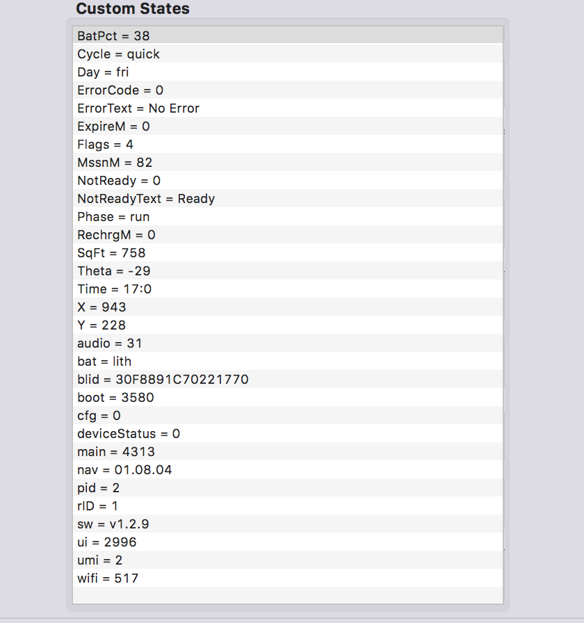

Re: Roomba Plugin - beta tests
Here's what I know about the Time and Mission states:
There are other codes that are missing from the Mission states currently being returned in the plugin:
From the sys command, the only ones I know about are sw and nav.
Day: Day of week, sun-sat
Time: Time of day
Flags: A decimal representation of binary preference settings. I haven't tried to decode yet - it usually is 3,4 or 5 when running for me.
Cycle: What the robot is currently doing. I have found it returns 'none' or 'clean'
Phase: What part of the Mission the robot is completing. Returns 'charge', 'stuck' or 'run'. If stuck, there will be an error code.
Theta: The direction the robot is pointing.
X: Robot's polar coordinate
Y: Robot's polar coordinate
DBatPctate: (Don't know - typo?)
MssnM: Elapsed Mission duration in minutes.
SqFt: SqFt cleaned.
ErrorCode: Error number from 1 to 18
ErrorText: Error text as documented by iRobot
NotReady: Codes are not documented anywhere - I have discovered 7: Bin Missing, 15: Low Battery, 16: Bin Full
NotReadyText: Text representation of those codes
ID: Always returns 1 for me.Code: Select all
batPct: Battery % remaining.
expireM: Minutes remaining to clear a stuck, pause, not ready, or error event before Mission is cancelled.
rechrgM: Minutes to complete recharging the batteryInsteon / Z-Wave / Bryant Evolution Connex /Tesla / Roomba / Elk M1 / SiteSage / Enphase Enlighten / NOAA Alerts
- Posts: 7830
I get mostly the same, except mine is currently showing Cycle=quick. Mine is set for single pass. Is yours single or double?
The version I'm running (0.0.4) is showing batPct, ExpireM, and RechrgM. Do you need to stretch the window?
- Screen Shot 2016-12-02 at 5.05.59 PM 12-2.png (95.52 KiB) Viewed 4458 times
