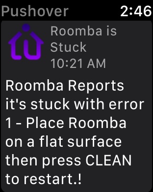

Probably. I want to be able to send the message to Pushover, along with the descriptive text and I would prefer not to create a new trigger for each error state. Currently I have a trigger to send a Pushover message with the contents of roombaErrorText whenever roombaError >0 (in my version of the code).

Maybe I'm misunderstanding you, or we're misunderstanding each other. What I want is to be able to send the specific error or not ready message to Pushover without having to create a trigger for each type of event that the plugin can report. That's what I currently do with my script.
