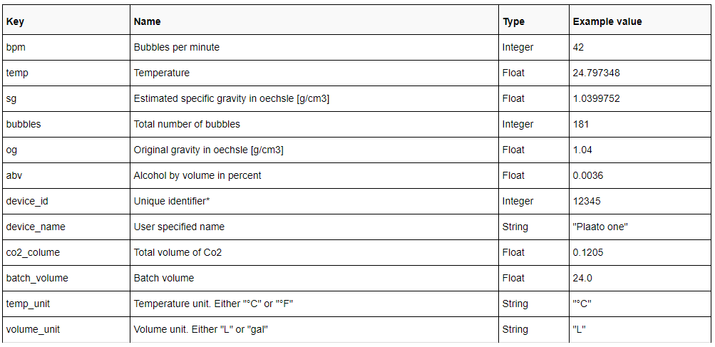

I have gotten a new gadget for my "brewery". This time it is a digital air lock that will count the bobbles and do several estimations based on that. The interesting thing is that this device supports webhooks, so it should be able to interface with Indigo.
The Plaato Airlock will send a POST request with a JSON object to the webhook every 5 minutes as long as it is connected to power and WiFi.
https://plaato.io/apps/help-center#!hc-values
The big question now, is it possible to use the HTTPd Plugin to interface this device?
/Håvard
/Håvard

Yes.haavarda wrote: The big question now, is it possible to use the HTTPd Plugin to interface this device?
Oh, you want to know how?
FIrst, set up the HTTPd plugin. Make sure you fill in the DDNS name field. If the device is on the local LAN, and it's the only device you're using with the plugin, you can use the local address of the Indigo server instead of a DDNS name. Something like "http://<indigoservername>.local/" or "http://192.168.1.101/".
Test that the HTTPd plugin is working properly. Use 'curl' in the Terminal window to test it, don't use a browser.
Something like this with set a variable named http_foo:
curl http://192.168.1.101:5555/setvar?foo=bar
httpPlugin = indigo.server.getPlugin("com.flyingdiver.indigoplugin.httpd")
if httpPlugin.isEnabled():
hook_data = httpPlugin.executeAction("getWebhookData", deviceId=1375148185)
indigo.server.log("Webhook Payload:\n{}".format(hook_data))
curl -d '{"key1":"value1", "key2":"value2"}' -H "Content-Type: application/json" http://192.168.1.101:5555/webhook-1375148185
Script Webhook Payload:
Data : (dict)
payload : (dict)
key1 : value1 (string)
key2 : value2 (string)
request : (dict)
client : 192.168.1.101 (string)
command : POST (string)
headers : (dict)
accept : */* (string)
authorization : Basic aG9va191c2VyOmhvb2tQYXNzMTAx (string)
content-length : 34 (string)
content-type : application/json (string)
host : 192.168.1.101:5555 (string)
user-agent : curl/7.54.0 (string)
path : /webhook-1375148185 (string)
vars : (dict)
You'll need to parse the payload part of the webhook data for your data. That's not too hard in Python. Depends on what you want to do with it.

Thank you for your reply and input FlyingDiver
I was able to get your tests for work. So just need to sort out the rest. I thought that the communication was direct, but it might be a cloud thing, so then I need to open some ports etc...
But it seams as I do some sort of polling with a get funcion. GET http://plaato.blynk.cc/auth_token/get/pin. And perhaps I can use the GhostXML.
I have requested a token from Plaato, and will start play with it to see what I can make of it.
Thanks again for your support
Håvard
Håvard
