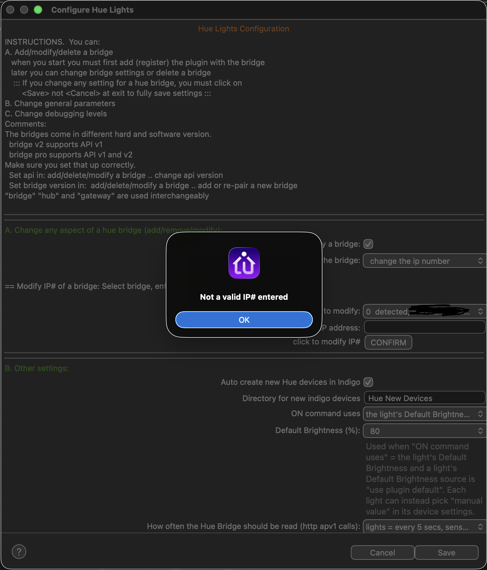

When I go to Plugin>Hue Lights>Config>Add/Delete/Modify a Bridge>Change the ip number and fill in the IP address from the Hue app for the Bridge Pro the plugin tells me that it is an invalid ip #.

When I enter the new IP address (which I get from the Hue Bridge) and click Confirm the new IP address is erased and this warning box appears.

Re: No devices after bridge change
you tried to change the ip number, but the bridge is not defined yet. select
"add or re-pair a new bridge"
I will need to fix the error message.
Your error message should have been: „first setup new bridge“
