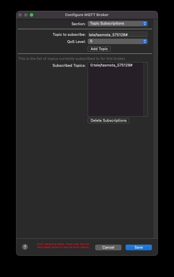

I'm having a problem setting up my first MQTT device. Apologies if I'm missing something blatantly obvious here.

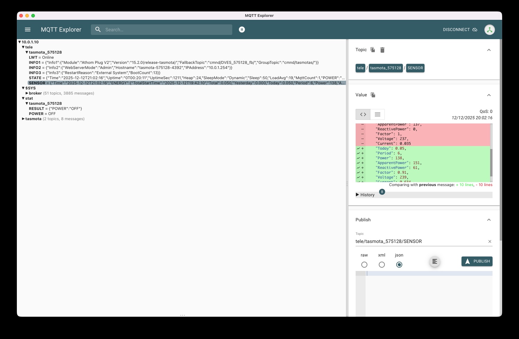

So I've got Mosquito setup in docker and that's working correctly as best I can tell. MQTT Explorer shows the device as expected:
I go to the MQTT Plugin and set it up like in the step by step guide (viewtopic.php?t=24227)
When I go to save I get an error at the bottom saying error validating fields, but there's no red labels to check the details about:

I'm not sure you can put a wildcard "#" in a topic string, except by itself. So put a slash before the hash.

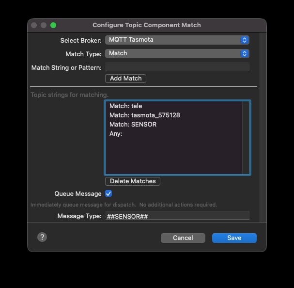

The trigger is setup correctly as best I can tell:

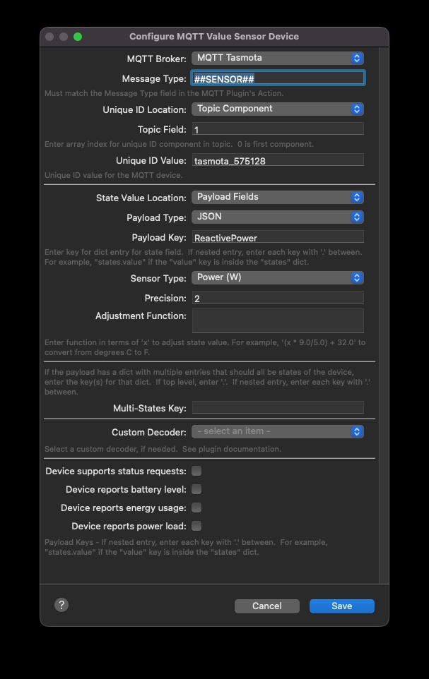

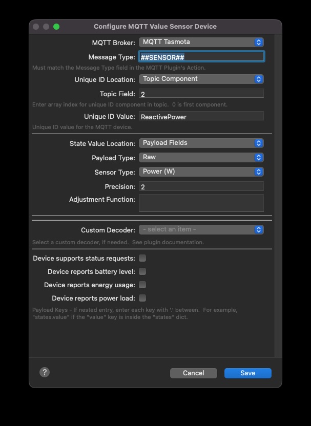

And this is the shim device config:
But It's not getting any updates or values or anything, just says sensor value 0 and the last update at the generic 2000-01-01. I've tried as many different permutations of the setup as I can, but nothing seems to make a difference.

Your match trigger is wrong. The last term in the topic is "SENSOR". So remove the "any" or change it to "end".

And your shim device is wrong. That's a JSON payload, not a RAW payload.
Re: Invalid subscription filter error on save
Your unique ID value is the tasmota_XXX field of the topic. which is location 1. ReactivePower is the key for the JSON payload.

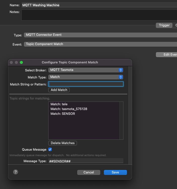

I think the trigger is now right as I'm getting triggers showing in my event log, but I'm still not getting anything coming through to the shim:
Trigger screenshot too in case I've somehow screwed it up too :D
Screenshot 2025-12-12 at 23.08.18.png (98.69 KiB) Viewed 322 times

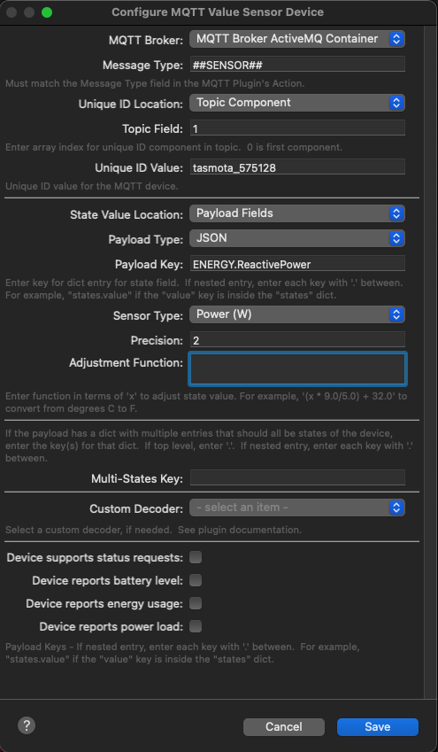

Post by cuhouse »
Durosity,
Your thread gave me the push to configure a Shim device that I have needed for awhile. I got mine working and then set up your scenario. Used the payload you supplied in this thread. I published it to my Shim device using MQTT Explorer and I was able to see the value update on my device. I changed the ReactivePower a few times and it updated.
This is what I used for my device.
Screen Shot 2025-12-13 at 11.44.26 PM.png (105.04 KiB) Viewed 221 times

cuhouse wrote: Sat Dec 13, 2025 10:54 pm Your thread gave me the push to configure a Shim device that I have needed for awhile. I got mine working and then set up your scenario. Used the payload you supplied in this thread. I published it to my Shim device using MQTT Explorer and I was able to see the value update on my device. I changed the ReactivePower a few times and it updated.
BAM! That was it! It was almost correct, I just had a space between the ENERGY. and ReactivePower.
Out of interest, I only seem to be getting an update of the power every 5 mins.. but it's updating a lot more frequently in the MQTT Explorer application.. are you aware of anything that could be causing that?
