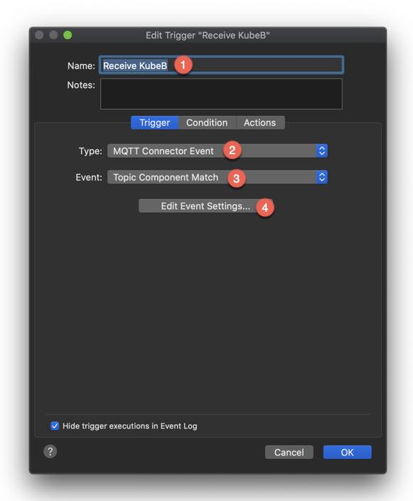

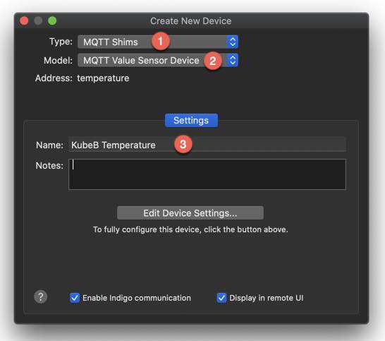

Hi there,
I'm very new to Indigo and it took me a little while to learn to use the MQTT/Shims combo. If you are newbie and lazy to read like me, perhaps this example would help a little bit.
First, I'm using a version of BKHobby's Kube. It is based on the Kube 1 but using the boards of the Kube 2. here you can find some info if you want to give it a try: https://www.pcbway.com/project/sharepro ... Board.html & https://www.thingiverse.com/thing:2539897 I think is a really cool project.

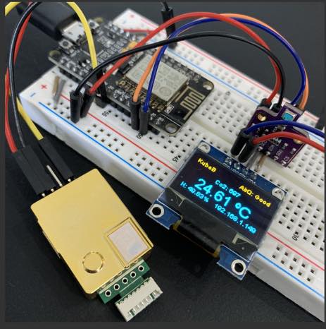

Anyway, I'm using this testbed with the BME680 and MH-Z19 sensors:

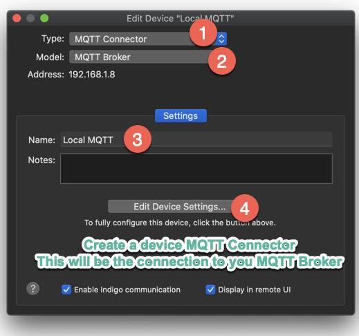

Let's start from the beginning... the combo plugin combo I mentioned before is:

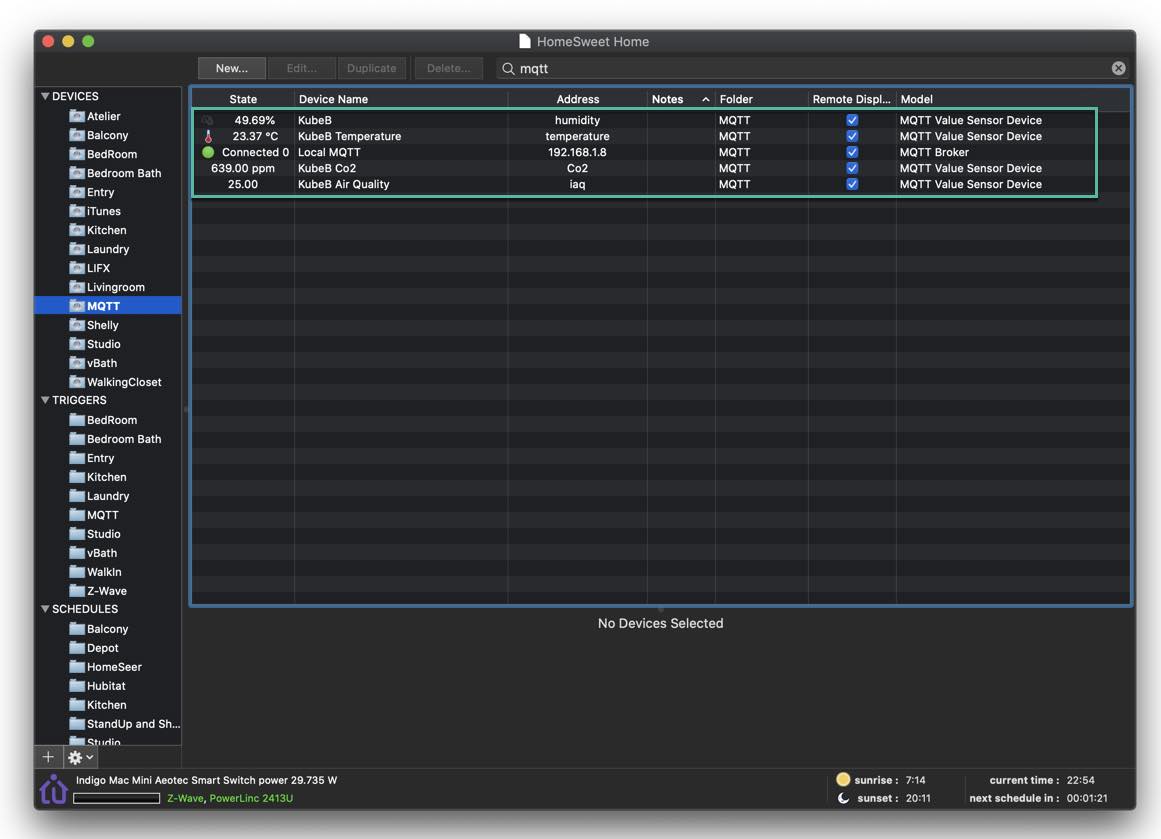

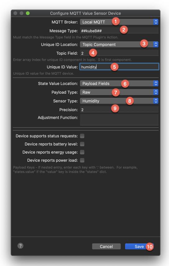

Then:
Can't put more than 10 attachments so I'll continue in another post.....
To be continued.... :P

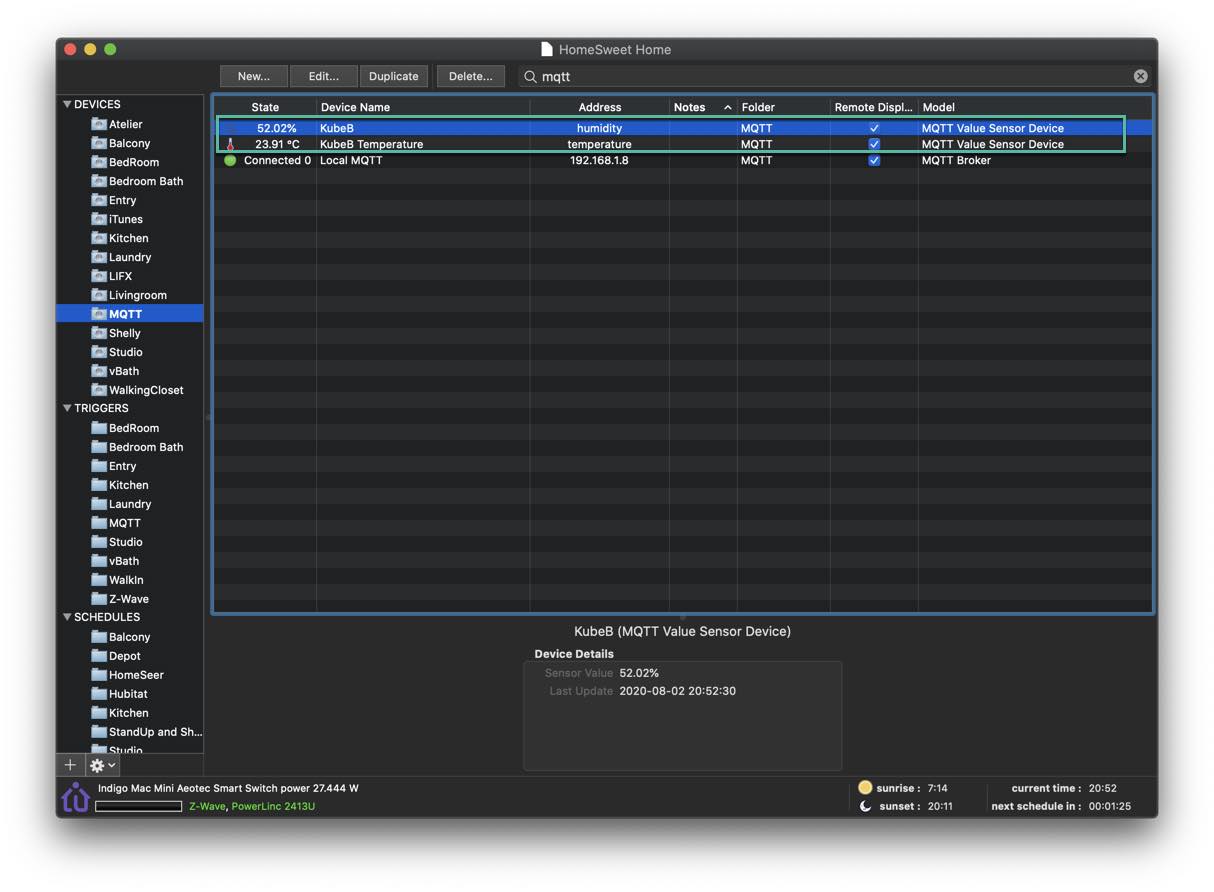

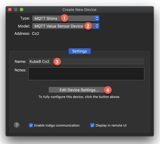

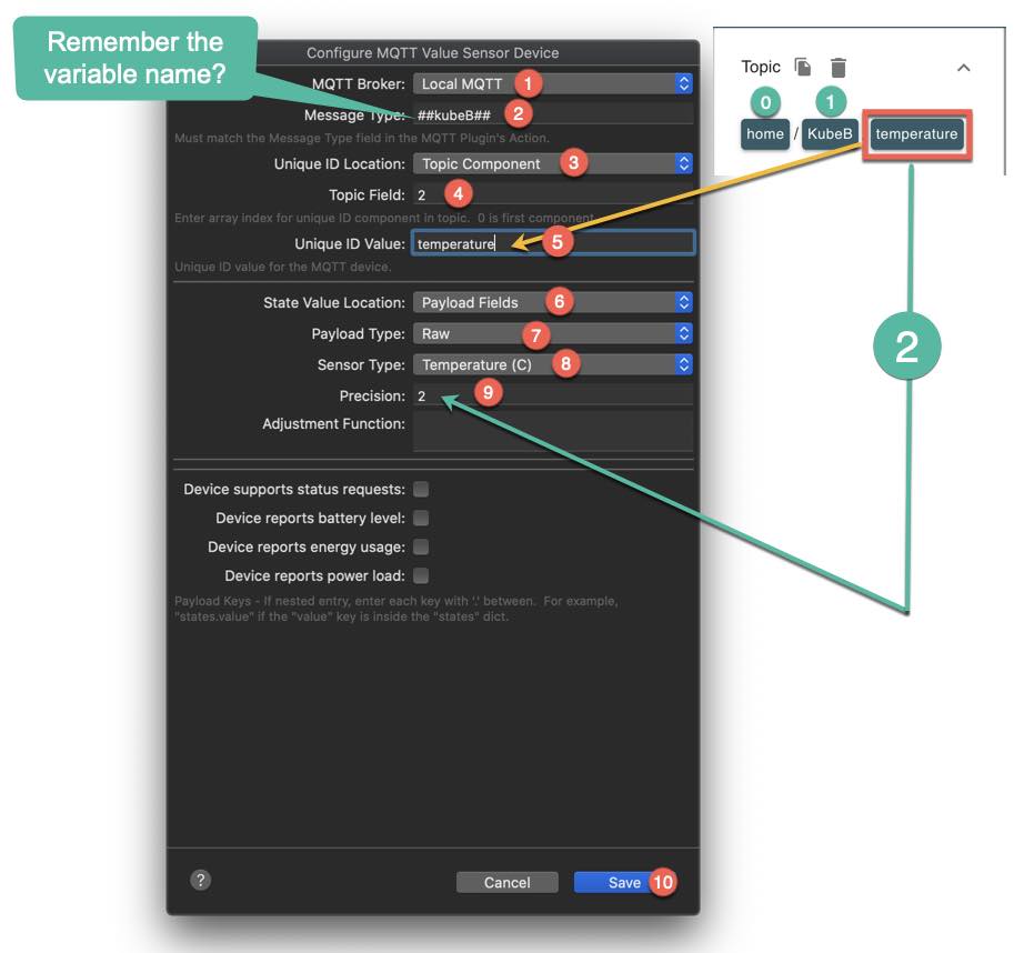

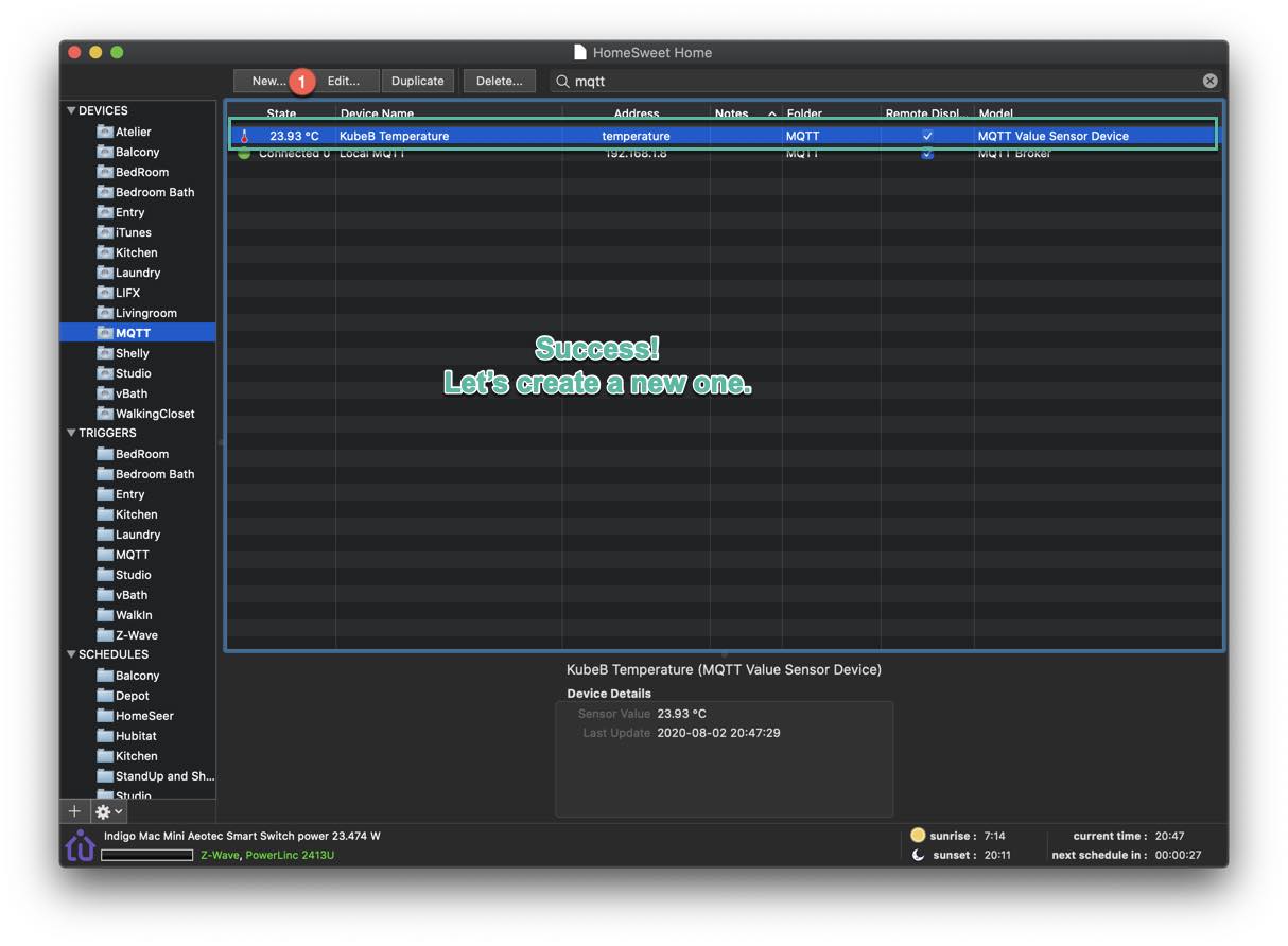

Continuing the previous post:
And to be continued to Part III... :P

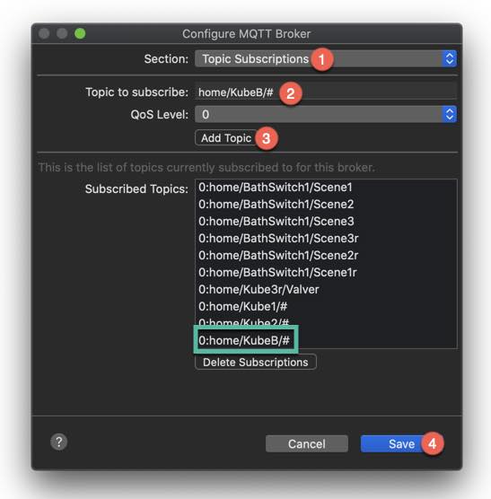

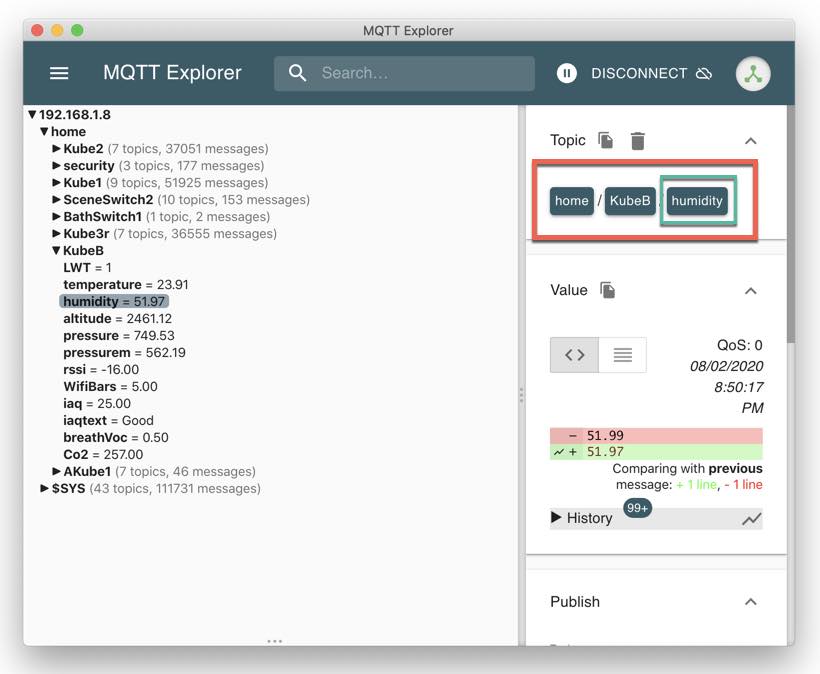

And third and last part:
Hopefully this sill help someone!!!
Enjoy...

Re: An MQTT config example to Newbies from a Newbie...
Very nice writeup. The only recommendation I would make at this point is that it's not necessary to list that many subscriptions. You could just subscribe to "home/#" and be done with it. ;)
