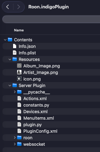

autolog
Posts: 4077
Location: West Sussex, UK
Re: Ungroup Zones?
Post by autolog »
Just catching up with your post.
That seems odd as the missing file should be part of the plugin? :?
Can you do a "Show Package Contents" on the plugin and check if the file is present?
racarter
Posts: 562
Joined: Sat Jun 18, 2016 4:23 am
Location: North Yorkshire, UK
Re: Ungroup Zones?
Post by racarter »
Well that was weird! When I looked in the plugins folder Roon wasn't there, even though the plugin was working (apart from the error messages). When I tried to reinstall it I got a message saying the plugin was faulty and couldn't be installed. I then tried to disable it and got another error message, so I restarted the Indigo server and the plugin had disappeared. I reinstalled it and the folders and files are all present and correct, so I'm expecting no further issues.
Never encountered that one before!
autolog
Posts: 4077
Re: Ungroup Zones?
Post by autolog »
That's a bit of a mystery - I haven't seen that happen before? :?
Well at least it is back working again for you. :)
