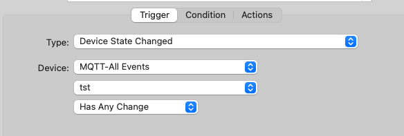

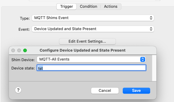

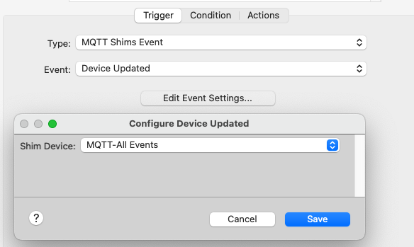

I want to trigger off the activity of a shim device. (every update of the device). I first set up the trigger using the shim specific triggers, but the trigger never 'triggers'. Setting up the trigger as a 'device state change' does work. Is this normal behavior, a plugin issue or user error: (Note: There are no conditions with any of these. The action just executes a script.)
Trigger 1 (never 'triggers'):
Trigger 2 (never 'triggers'):
Trigger 3 (Triggers as expected/action runs):

That's strange. I need debug logs for both the connector and shim plugins when one of these messages arrives. Probably better to create a GitHub issue for this.
