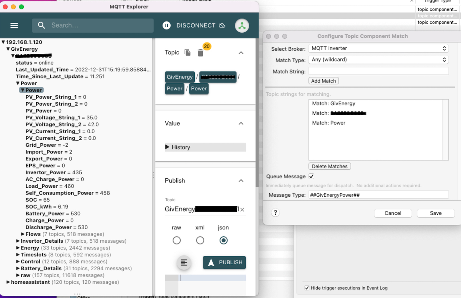

Hi all,
I'm trying to get information from my battery inverter via MQTT, which i've managed to do quite successfully. However I can't get the information from the topic GivEnergy/SA2230***/Power/Power/Grid_Power because when configuring the topic component match, it will not let you have two names that are the same I.E. "power" "power".
Is there any way around this?
Items with black lines though are my inverter serial number.
Screenshot 2022-12-31 at 15.20.06 copy.jpg (455.69 KiB) Viewed 1777 times

Huh. I'll have to look at that. Can you open an issue for this in the GitHub repository?

Ok, i'll give it a go, not done that before! :shock:
Done!

Wow, super quick reply! Thank you, i'll give it a try now :D

Tested and all working, thank you :D
Super impressed, fixed in under two hours!! Happy New Year Flying Diver!!
