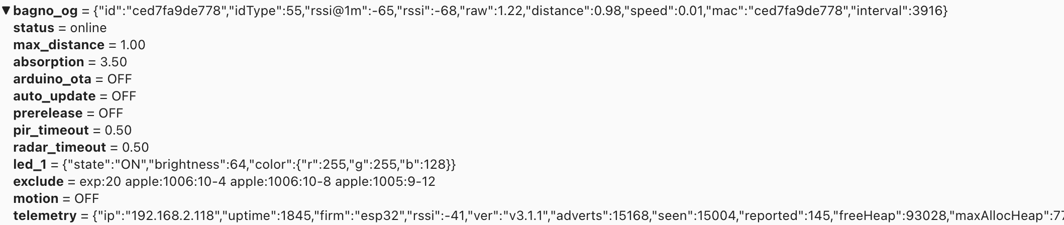

I have the famous MQTT tree (see image).
I would like to have the value of "id" ("ced....") into a variable or state device (variable would be better), how can I do it?

You need to set up a trigger and Generic JSON device for the topic "espresense/rooms/bagno_og". Because there are other topics with more components after that, you need to use the End term as follows:
Once you do that, you set the "multi-states key" to "." per the instructions in the config dialog. Then all of the items in that dict (id, idType, etc) will be states for that device.
If you really want them in a variable (why?) you would need to set up a trigger that fires whenever that state changes to copy the value to the variable.

Ok, thanks, but I do not understand how I have to setup the device.
What shall I put into "Unique ID Location"? And then?

Same as all your other devices. "bagno_og". The string that's in the "Any" slot in the trigger.MarcoGT wrote:Ok, thanks, but I do not understand how I have to setup the device.
