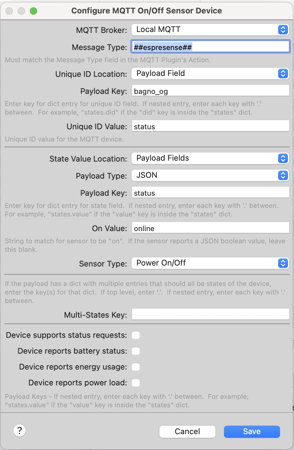

I am trying to playing a little bit, but without success, so far I have:
Why is trying to get "status" key from "telemetry"?

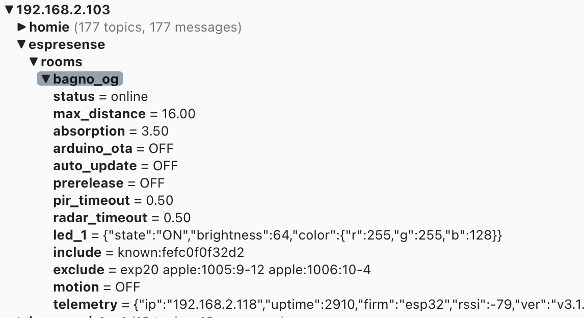

Re: Help with MQTT
Marco,
From the MQTT Explorer information you provided, status is not JSON. Payload Type: Raw from what I see.
Jody
Jody

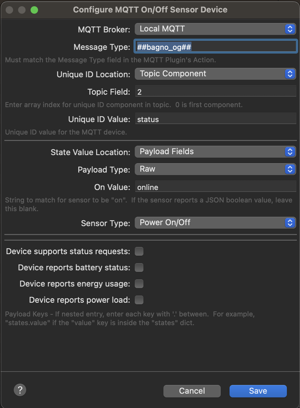

Re: Help with MQTT
Also the UID ('bagno_og ') is not in the payload, it's part of the topic. Third part, which makes it field 2 (zero based).

Thanks a lot for the inputs, but I think I am still missing something

- Posts: 7830
Re: Help with MQTT
You didn't fix either of the issues pointed out to you already.

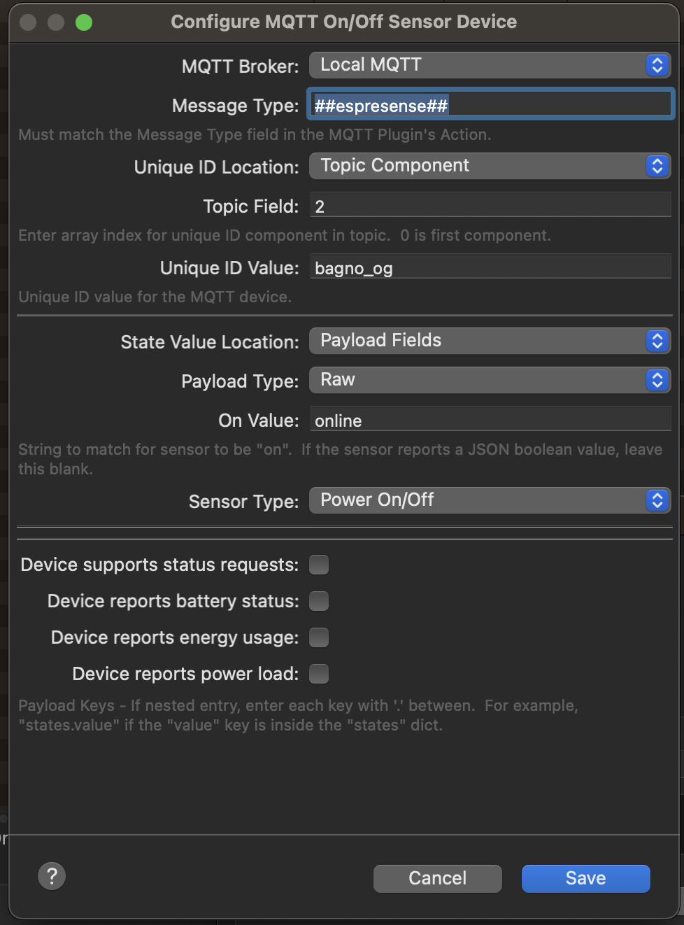

Re: Help with MQTT
Sorry, you are right, uploaded wrong screenshot
- Screenshot 2022-12-14 alle 17.49.24.png (252.1 KiB) Viewed 2915 times

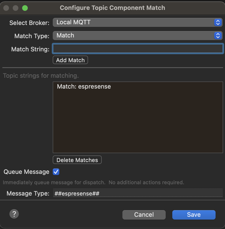

Re: Help with MQTT
Looks to me like your trigger is matching on any of the messages from the device, not just the status topic. I don't see any status topic messages in the log excerpt you posted.
Re: Help with MQTT
This is my trigger
- Screenshot 2022-12-14 alle 21.31.13.png (116.52 KiB) Viewed 2902 times
- Posts: 7830
Re: Help with MQTT
Yeah, that's not going to work. You need to trigger on the specific message topic for the value you're looking for, which is "espresense/rooms/bagno_og/status". So you need:
The any is there because if you if have multiple devices, you want the trigger to work for all of them, identified by the uniqueID (bagno_og)
Match: espresense
Match: rooms
Any:
Match: status
End:joe (aka FlyingDiver)
Re: Help with MQTT
It worked!
Thanks a lot!

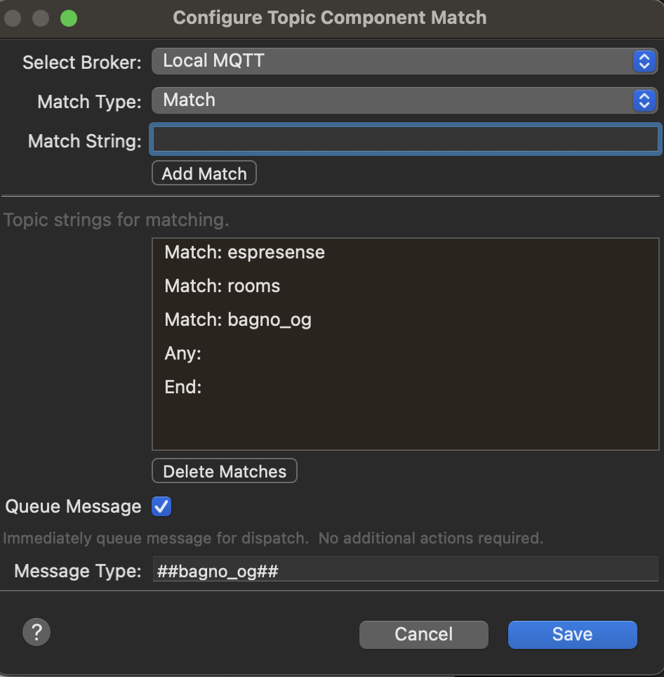

Re: Help with MQTT
Now I am doing something different, because I would like not only to get the status value, but also other data in it.
My idea was to create a trigger for every /rooms/<device>, is this approach correct?
Therefore I would have as follows, but something seems wrong as it does not work
- Screenshot 2022-12-14 alle 22.01.04.png (221.83 KiB) Viewed 2897 times
- Screenshot 2022-12-14 alle 21.59.18.png (129.63 KiB) Viewed 2897 times
- Posts: 7830
Re: Help with MQTT
No. You can create a trigger for each message type you want to use, but they're re-used for multiple devices.MarcoGT wrote:Now I am doing something different, because I would like not only to get the status value, but also other data in it.
The Shim device represents a specific value (or possibly set of values) for a specific MQTT topic message. So you can use a trigger for all devices for THAT message type. Each message type represents a different topic. Each topic/uniqueID combo maps to a different Shim device.
