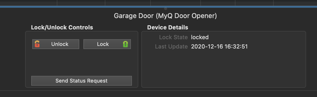

Send status request triggers this log message:
MyQ Warning getDevices failure, status_code = 400
The plug-in works fine but always shows the garage door as "Locked".
Seems to be functioning fine, but unable to update status.
Running
Catalina 10.15.7
Indigo 7.5.0
MyQ Plugin Ver. 7.5.3
Any thoughts?
Running
Catalina 10.15.7
Indigo 7.5.0
Any thoughts?

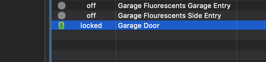

Thanks for your reply Joe,
Yes, that is correct, functionality is there, but the status never changes and shows Locked status.
Here is the MyQ logging, I opened the door via Indigo at 06:06:25.
It appears that it is unable to get the status code for some odd reason.
It also appears that the last status update was back in December??
Apr 2, 2021 at 6:04:24 PM
Z-Wave received "Outdoor Motion Sensor" status update is on
Z-Wave received "HVAC Exit Air Temperature" temperature update to 76.6 °F
Apr 2, 2021 at 6:05:53 PM
MyQ Debug logLevel = 10
MyQ Debug myqLogin response = {"SecurityToken":"ac862af4-6fc1-4a63-8e0d-82804af18809"}
MyQ Debug myqLogin successful
MyQ Debug statusFrequency = 600.0
MyQ Debug myqLogin response = {"SecurityToken":"a80afef3-3959-4425-9644-c83d069b7046"}
Apr 2, 2021 at 6:06:25 PM
MyQ Debug actionControlDevice: Unlock Garage Door
MyQ Debug myqLogin response = {"SecurityToken":"35980adc-1267-4cfd-a663-ec0cb966d55f"}
MyQ Debug Garage Door: changeDevice: new state = open
MyQ Debug myqLogin response = {"SecurityToken":"f9636ad0-0a80-43c5-a733-a4ea89cc280e"}
