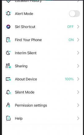

Re: piBeacon: 7- tested Beacons
ok so it can not connect. that SHOULD mean that the iPhone still OWNS it = not other device can connect -- these devices can only have one master at a time.
make sure the nut app is not active - also not in the background on your phone
then please check the nut app parameters: mine look like:
Screen Shot 2021-01-11 at 16.36.22.png (127.58 KiB) Viewed 4827 times
Screen Shot 2021-01-11 at 16.33.41.png (117.81 KiB) Viewed 4827 times

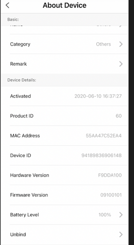

siclark
Posts: 2355
Location: UK
Post by siclark »
This one had never been connected to the Nut app but I’ve now done so to grab the identifiers. I’ve killed app in background as well.
Appears different hardware and firmware.
