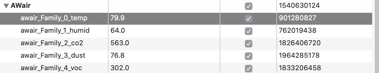

Something is trying to convert an empty string to an integer. Which doesn't work. Are you sure that variable has an appropriate value in it?
Re: Error: Invalid literal for int() with base 10:
I think so. See image.
- Screen Shot 2020-11-12 at 11.02.18 AM.png (185.04 KiB) Viewed 5087 times
