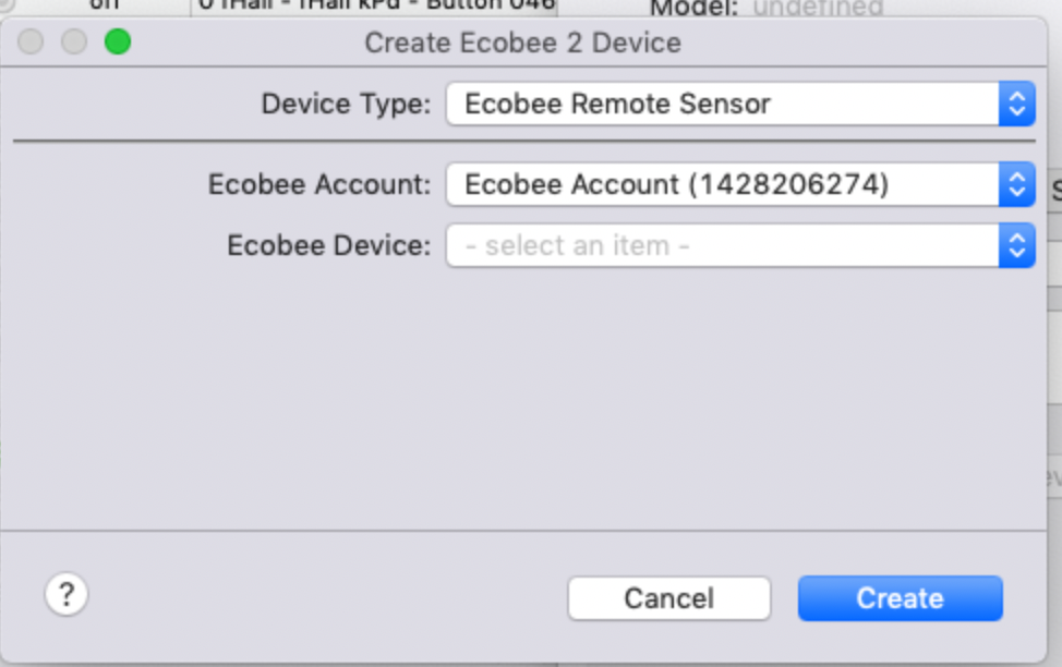

I have a new Ecobee thermostat (SmartThermostat with voice control), firmware ver 4.16.15.142, and one remote sensor. I have reloaded the plug-in, but am unable to see the remote sensor.

Wait. I thought you mean that the plugin didn't see the remote sensor, so you couldn't create an Indigo device for it. But you said you did create the device.
Please explain exactly what you have and what you mean by enable to see the sensor.

In the house, I have 1 thermostat and 1 remote device.
Ecobee knows about both the thermostat and the remote device.
When setting up the thermostat, I do not recall whether or not I had the remote device configured with Ecobee when I created the Ecobee connection with Indigo.
Indigo knows about the thermostat, but I am unable to create a device in indigo for the remote sensor.

- Screen Shot 2020-09-14 at 11.50.57.png (247.51 KiB) Viewed 3665 times

That says you already have an Indigo device for the remote sensor, named 'Ecobee Front Hall Remote - North Office'.

But why can't a create a device in Indigo?
What I am trying to do is use the occupied state as a trigger to monitor inside activity in our home when we are away.
I just discovered that I can do that - the device is available for a trigger and listed as a device when I search for ecobee. What confused me is that the remote sensor wasn't mentioned in the dialogue for creating a new device, while the thermostat was mentioned.

You can't create it because it already exists.SMUSEBY wrote:But why can't a create a device in Indigo?
What's probably confusing you is that the occupancy sensor is not created as a separate device. It's the on/off part of the temperature sensor device.SMUSEBY wrote: What I am trying to do is use the occupied state as a trigger to monitor inside activity in our home when we are away.
