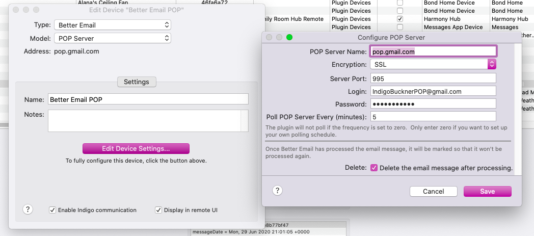

Next time it runs it ignores the email.
Here's the config:
Screen Shot 2020-06-29 at 9.50.33 PM.png (177.75 KiB) Viewed 3410 times
Re: Not deleting message after processing
ryanbuckner wrote:Next time it runs it ignores the email.
Here's the config:
That's what I would have expected if you didn't have the delete option selected. Did you change that after the first time it was scanned? If it was already read once, it won't process it at all, so it won't get deleted.
