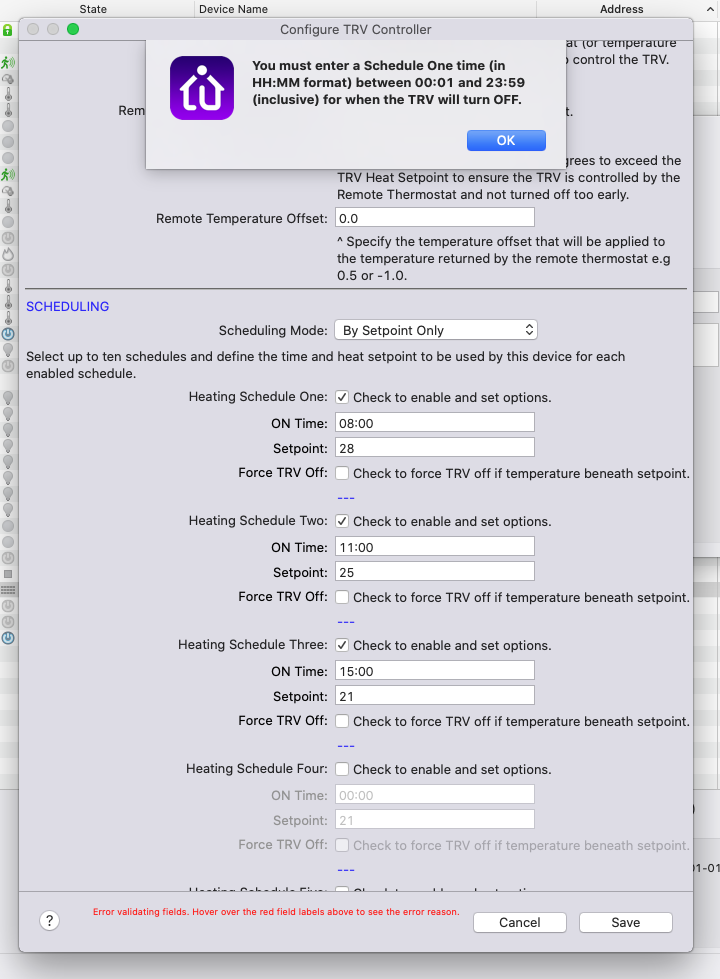

Testing a new version
Creating a device.
Validation could not be passed - requiring "off" time for setpoint devices :)
Screenshot 2020-02-17 at 10.46.13.png (193.69 KiB) Viewed 6347 times

shapa wrote:Testing a new version
Creating a device.
Yes - I haven't finished coding the 'By Setpoint Only' option. Even though you can select it, the plugin will only process ON/OFF at the moment.
I should have made that clear when I uploaded this pre-release version which was mainly just to support the MQTT Shim devices. :)

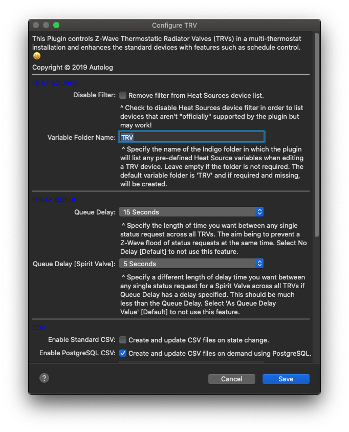

I have just completed the implementation of this feature and will test it over the next day or so before releasing it to Github as pre-release Version 1.5.0:
Here is sight of the new plugin config dialogue:
TRV Controller Configuration Dialogue
The Queue Delay can be specified as: No Delay, 10 Seconds, 15 Seconds, 20 Seconds, 30 Seconds, 40 Seconds, 50 Seconds or 60 Seconds.
The Queue Delay [Spirit Valve] can be specified as: As Queue Delay Value, 5 Seconds, 10 Seconds, 15 Seconds or 20 Seconds
The Queue Delay [Spirit Valve] is only taken account of if a delay is specified for Queue Delay i.e. it will be ignored if Queue Delay is specified as No Delay.
This should cover the majority of the situations but not a plugin startup / reload but then this shouldn't happen too often (hopefully). :)

I have now posted Version 1.5.0 to Github as a pre-release: TRV Controller V 1.5.0 - Add User Specified Z-Wave Delay Between Status Requests
It actually does work on plugin start / reload. :)
All seems to work OK as far as my system is concerned.
If you have the delay set to 15 seconds and valve delay set to 5 seconds then to start each TRV will take 20 seconds. If you have 12 TRVs, it is going to take 12 x 20 seconds = ~ 4 minutes to complete and any new changes (e.g. turn on a TRV) will be queued up behind the initial start.
