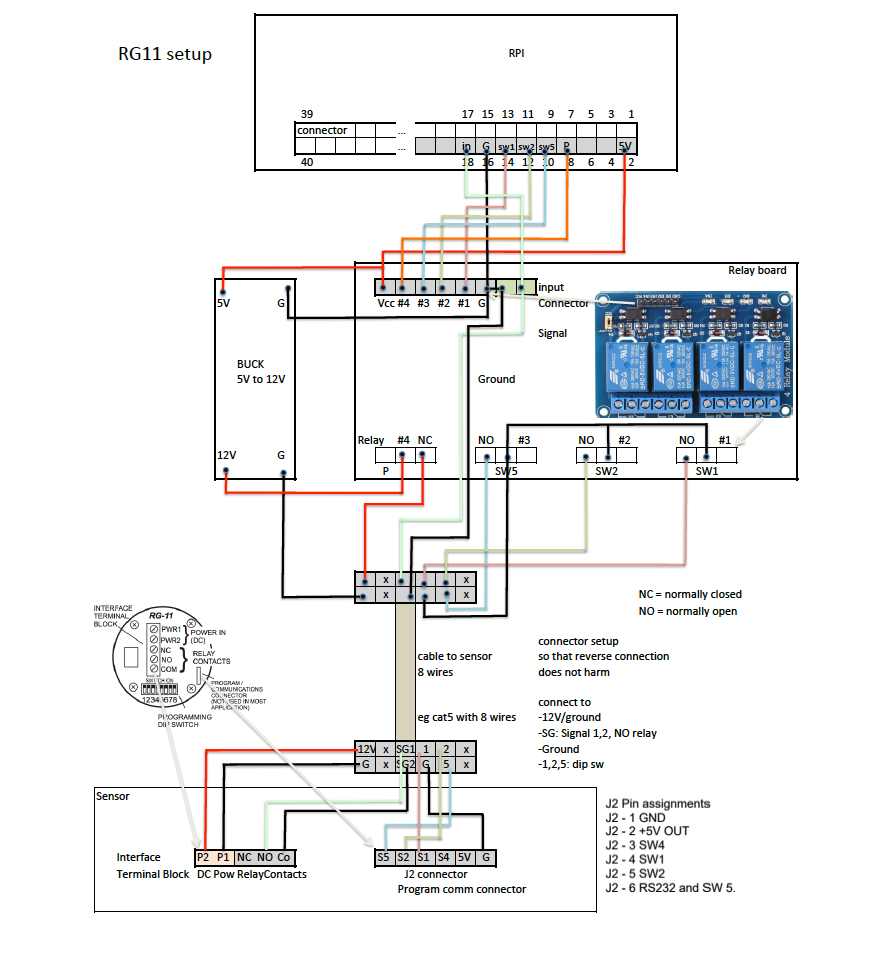

In order to fully use the capabilities you need to switch the switches on the rain sensor with eg relays.
The attached drawing shows how to attach a RG11 rain sensor to the RPI through a relay board.

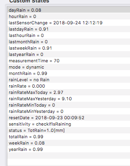

The states of the indigo sensor device look like:
Screen Shot 2018-09-24 at 12.27.10.png (34.73 KiB) Viewed 13667 times
(units in mm]
you can set the rain units and digits in config.
In device edit you can select various timing settings and modes as well as formatting of the status field
The rain amounts can be reset in pibeacon menus under "Reset or Request new data ... "
at each hour/ midnight/ week/ month/ year the amounts shift to lastHour/lastDay...
at midnight Max and Min rain rates are calculated and shifted to lastDay

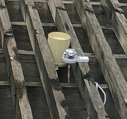

RG11 next to a common bucket rain sensor
Screen Shot 2018-09-24 at 12.34.13.png (269.33 KiB) Viewed 13663 times

Still havent got around fiddeling with this, :oops: but i noticed the 52pi relay addon, would this setup work with a 52pi hat? That would be a nice setup.
Re: piBeacon: 18 - RG11 rain sensor setup
not in the current form, but I can adopt that.
currently it sets the relays through GPIO on/off.
that board uses i2c to set them, not a big deal to add that.
I actually really like that board well done, good software support, good docu. only draw back is only 3Amps current.
For this app you only need mAmps.
so if you decide to try that version I can add it quickly
Asconasny
Posts: 161
Joined: Fri Jan 16, 2015 5:05 am
Post by Asconasny »
Ive placed a order for a couple of the relays when i saw they got supported i pibeacon, Figured it could be nice to have on a rainy day :)
If its not to much trouble to add the option it would be perfect to use one of them on the rain sensor instead of the relay board.
It is done ~ 1 hour, but not tested, if you could try, I hesitate to rip mine apart
52pi relay hard wired setup:
relay 4 = 12V
relay 3 = dip switch 5
relay 2 = dip switch 2
relay 1 = dip switch 1
will publish this week, need to test some other things
did a dry run and the relays click in the right way w artificially created rain (connecting the gpio-IN pin to ground / off frequently)
It goes through sensitivity cycle with relay clicks the proper way: check if rain / high/med/low sensitivity and back
and for your relay you just need to see if anything can still leave China .. :lol:
