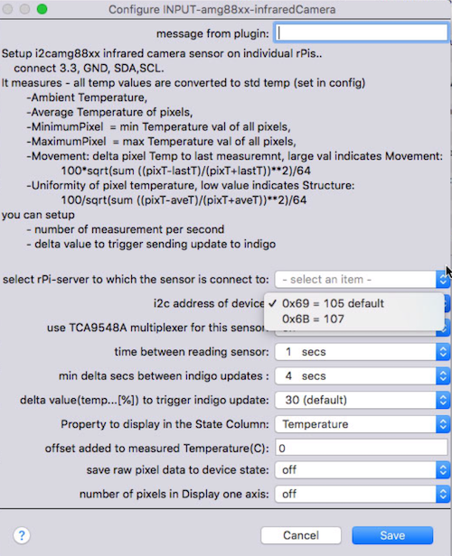

I've started having a look at the AMG8833 sensor, as a presence detector where a person is stationary - looks like this could work quite well.
A single sensor would work for most rooms, however for larger rooms 2 sensors may be required.
My understanding for these sensors (I'm trying out the Sparkfun Qwiic board) is that the alternative i2c address is 0x68 (the default being 0x69) - however the plugin has the options of 0x69 and 0x6B. Can this be amended to add 0x68?

Re: AMG8833 sensor i2c address
Sure .. later today
When you plugin the sensor do on the rpi
i2cdetect -y 1
It will show you the actual address the sensor uses.

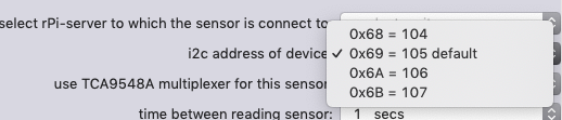

posted v .294 with added i2c address.

Awesome - thanks!
Sensors up and running - now to find a suitable case or mounting...
