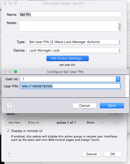

However, using the %%v:123456%% format (which I've doublechecked that I've used my own variable ID) doesn't seem to work.

Action setup
Screen Shot 2018-07-05 at 5.29.53 PM.png (76.4 KiB) Viewed 5393 times
The PIN is unchanged.
  Action Group                    Set Pin
   Z-Wave Lock Manager             Setting PIN for user 1 to: %%v:710549162%%

...and I feel like a dummy. I downloaded what I thought was the latest version from the pinned post in this subforum. I got the real latest version from the plugin store, and it works fine now.
