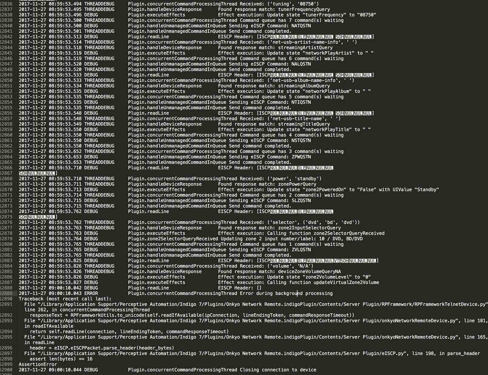

I spoke too soon. I am getting these errors:
Nov 17, 2017 at 9:40:28 AM
Onkyo Network Remote Plugin Error Error during background processing
File "/Library/Application Support/Perceptive Automation/Indigo 7/Plugins/Onkyo Network Remote.indigoPlugin/Contents/Server Plugin/RPFramework/RPFrameworkTelnetDevice.py", line 262, in concurrentCommandProcessingThread
responseText = RPFrameworkUtils.to_unicode(self.readIfAvailable(ipConnection, lineEndingToken, commandResponseTimeout))
File "/Library/Application Support/Perceptive Automation/Indigo 7/Plugins/Onkyo Network Remote.indigoPlugin/Contents/Server Plugin/onkyoNetworkRemoteDevice.py", line 179, in readIfAvailable
return self.readLine(connection, lineEndingToken, commandResponseTimeout)
File "/Library/Application Support/Perceptive Automation/Indigo 7/Plugins/Onkyo Network Remote.indigoPlugin/Contents/Server Plugin/onkyoNetworkRemoteDevice.py", line 164, in readLine
header = eISCP.eISCPPacket.parse_header(header_bytes)
File "/Library/Application Support/Perceptive Automation/Indigo 7/Plugins/Onkyo Network Remote.indigoPlugin/Contents/Server Plugin/eISCP.py", line 198, in parse_header
assert len(bytes) == 16
AssertionError

I'm wondering if you wouldn't mind taking a quick look at this for me. I booted up a VM with Indigo and confirmed that your plugin works fine with my Onkyo configured on OS X El Cap. In High Sierra, several functions cause the plugin to fail according the debug logs that comes out of the plugin. Zone 2 state changes, in particular, seem to be causing problems.
I've attached a list of my logs during a restart of the plugin. Both Indigo instances have the same Onkyo configured.
Hopefully I can help fix this myself but I'm so far at a loss as to what is happening. Appreciate if you can help.

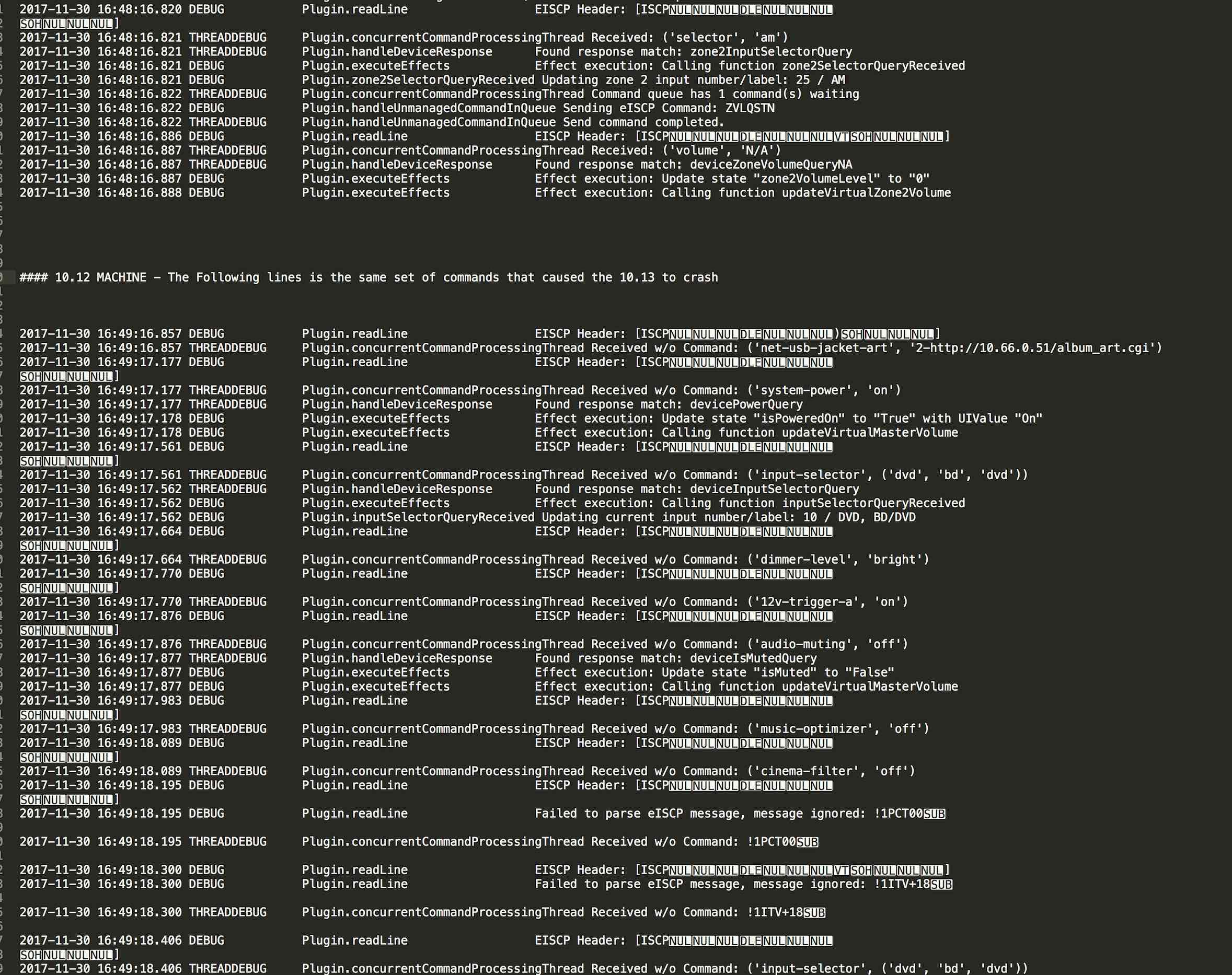

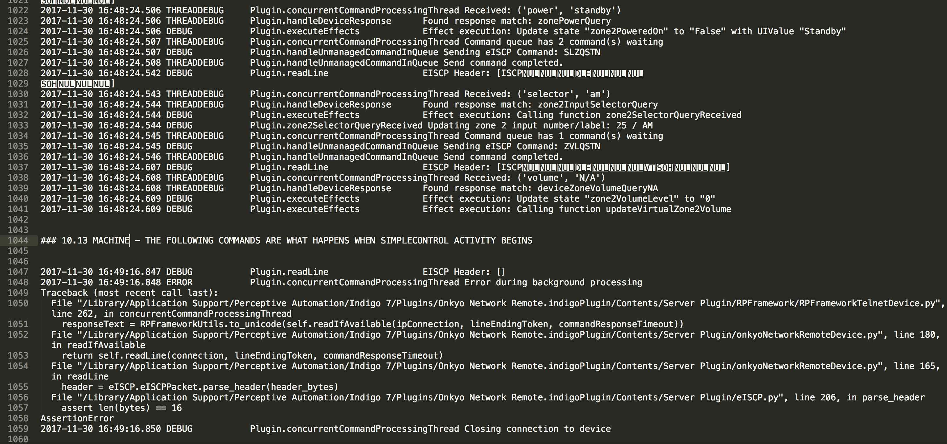

Re: High Sierra
Okay. This is bizarre. I booted up my OS X 10.12.6 again, and tested SimpleControl interacting with the Onkyo, and your plugin handled the updates just fine. I cannot figure out which individual updates are being received that are being processed differently only on my HS box. What I know for sure is that your plugin works fine when Simple Control is not open on any of my iDevices. I can't seem to do anything in the native Onkyo controller app that replicates what is happening in Simple Control, but this could be just a command that I'm not aware of. Since SimpleControl is interacting with the Onkyo directly, and your plugin is getting feedback from the Onkyo, I'm back to my original hypothesis that there is some difference in interpretation between El Cap and High Sierra.
Test 2 below shows some bizarre characters in the debug log. Does that look right to you?
Side by side test: Launching Simple Control after restarting the plugin. First code block is HS (Crash). Second is El Cap (handles fine).
Side by side test 2: Restarting the plugin while SimpleControl is already open:
File "/Library/Application Support/Perceptive Automation/Indigo 7/Plugins/Onkyo Network Remote.indigoPlugin/Contents/Server Plugin/RPFramework/RPFrameworkTelnetDevice.py", line 242, in concurrentCommandProcessingThread
responseText = RPFrameworkUtils.to_unicode(self.readLine(ipConnection, lineEndingToken, commandResponseTimeout))
AssertionError
Onkyo Network Remote Plugin Debug Closing connection to device

When I add the logging line you recommended (the first one worked), the Indigo log shows an empty set for headers for the commands that fail. Interestingly, I went to your plugin log folder to look at the log without other chatter from my network, and found strange characters for some of the commands, others had a empty set.
EDIT: If you would like me to add your second line of code, I might need further instructions. My Python is pretty basic.
Full log file is attached (compressed), Sublime text doesn't seem to know what to do with these characters.
Full log: https://www.dropbox.com/s/rlnn0fu0k7cx4 ... g.zip?dl=0
Also, to make it easier to quickly review, I took a screen grab.
Mike

The updated plugin did not fix the issue. I think I'm closer to getting an exact comparison between the logs of the commands that are causing the crash. I'm hoping these help you more.
It seems the very first command that the plugin receives from SimpleControl immediately causes the crash. Hopefully the pattern is the same in that fixing one will fix them all, but who knows.
I'm fairly sure that the EISCP header for the command below the comment in my screenshot is the command that comes up as an empty set on the 10.13 machine and crashes. It contains a ")" character in the header, which stood out to me.
Let me know what you think.
- 10.12 Log.jpg (415.25 KiB) Viewed 5895 times
- 10.13 Log.jpg (415.06 KiB) Viewed 5895 times
