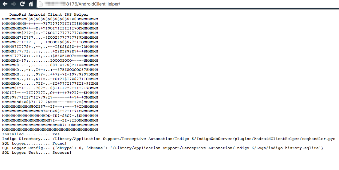

Hmm, that is curious as it indicates that the plugin's web component is not properly installed. Let's start with the basics and make sure the web server is up-and-running and accessible; if you could, please attempt to access your server (either on-server or on another client):
http://[IPADDRESS]:8176/
You should be prompted for your credentials... once on that page, at the bottom should be an entry for "Android Client Helper Plugin". If that is there click on it to see a terrible ascii art status page. :)
Adam
RichP
Posts: 7
Joined: Wed Mar 30, 2016 9:19 am
Re: Can't Pair Device with Android 6 Devices
Post by RichP »
That works and I tried it from the phone too from LTE and it also worked.

Hmm, okay then it appears my first inclination of the plugin not having been installed completely was incorrect and rather it is the communication between the Indigo Plugin and the Indigo Web Server Plugin pieces that is failing. Just to get the basics of the communication protocol out of the way first - did you configure the plugin with your username/password and are you using digest authentication in the server settings?
Was one of those attempts accessing the status page from the server itself? I can't think what would prevent you from accessing localhost when you got to it over LTE, though, but might as well be sure.

I can access that AndroidHelper status page both locally and then remotely using my reflector.

Post by RogueProeliator »
"The domotics Pad mobile client plugin is missing or mis-configured on the server."
The log says:
"undefined page requested "http://xxxxxxxx.indigodomo.net/AndroidClientHelper/registerAndroidDevice" from xxx.xxx.xxx.xxx"
That is indicating that you don't have the Domotics Pad Mobile Client Plugin installed on the Indigo server - or it is not running properly on the server. Assuming you have the plugin installed, please turn on debug for the plugin and restart it. Then post the output of the restart (from the Indigo log) here.
Adam

Post by bluefightingcat »
This issue was fixed when I updated to the latest version of the Plugin.
