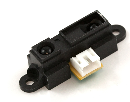

with the sharp proximity sensor GP2Y0A21YK $14 you can build a trivial short range proximity sensor to e.g. switch things on/off
connect red cable to +V5 (pin#2)
connect black cable to GND (pin# 6)
connect white cable (signal) to GPIO 23 (pin#16) (INPUT-0)
setup INPUT-GPIO sensor on the plugin: input open GPIO 23
waving your hand ~ 20 CM away from the sensor will trigger 1/0 in the plugin as shown on the attached movie
https://www.dropbox.com/s/fhlmxpeig9x68 ... r.mov?dl=1
(you need to click on the movie to see the 0/1/0/1/0/1 on the top of the screen)
It can get any simpler
and a pic of the sensor:
Screen Shot 2016-03-06 at 7.29.32 PM.png (207.14 KiB) Viewed 11814 times
