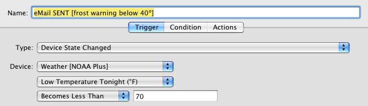

I like the idea of a frost warning to protect my citrus in So Cal.
So I tried this test:
Picture 1.png (25.89 KiB) Viewed 9766 times
The action is 'send a email'
I'm getting nothing. My test is for 70º and my current 'low temps' are in the 65º-68º range.
Am I correct in that the 'low temp' is a forecast, which is posted once [at what hour?] and doesn't move during the day like 'current temp'
'Becomes less than'. Does this mean that, at the 'low temp' posted time the temp is below 70º = email sent? 'BECOMES' sounds more like 72>71>70>69 email sent

CraigM wrote:Am I correct in that the 'low temp' is a forecast, which is posted once [at what hour?] and doesn't move during the day like 'current temp'
Correct. "Low Temperature Tonight" is the forecast for the evening. From my observations, it seems that around 6:00 AM is when NOAA sets this value for the first time in any particular day (e.g. early on Monday morning prior to 6:00 AM, the Low Temperature Tonight represents the low for Sunday night, after 6:00 AM, the Low Temperature Tonight represents the low for Monday night). The value can change if NOAA changes their prediction sometime during the day, but for the most part, it's constant for the entire day.
"Becomes Less Than" means that it has to first be greater than or equal to the value you enter. If the Low Temperature Tonight was never at or above the value you entered, that trigger will never fire. If you want Indigo to send you an email each time the low temperature is updated with a value less than 70, set the trigger to "Has Any Change" rather than "Becomes Less Than", then specify a condition in the Conditions tab that requires the "Low Temperature Tonight" value of the device to be less than 70. That way, each time the state is updated with a value less than 70, you'll get an email. NOTE, however, that NOAA Weather Plus, clears and re-updates each of it's states every 15 minutes. This means that you'd be getting an email every 15 minutes with the same information. I don't have an elegant work-around for this at the moment. I'll need to think about a better way to reliably update the device states without having to clear them out first. An update to improve upon this may not be available real soon unless a number of people have a pressing need though.

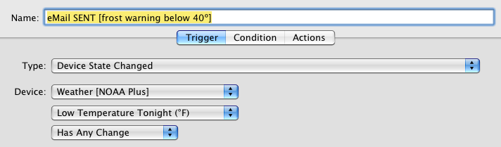

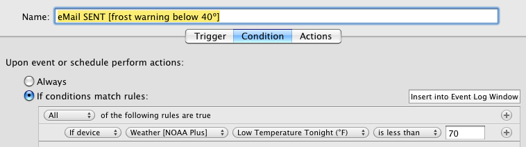

Post by CraigM »
Nathan, as usual thanks for the clarifications.
Are you sure about the 'email every 15 min'?
I reconfigured my trigger per your instructions on 10/17 at 2:00pm pst, but as of this posting I have only received one email on 10/18 at 4:06am pst.

nsheldon
Posts: 2469
Location: CA
Re: Frost warning
Post by nsheldon »
No, I'm not positive about the 15 minute thing. :) If you only received one email, it may be that I'm thinking of the current condition states that get updated every time the NOAA Weather Plus plugin checks. It's been a bit since I've looked at the code in detail. ;-)
