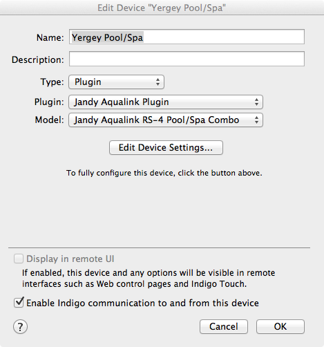

Create a New Device (example illustrated for RS-4 Pool/Spa Combo)
Type: Plugin
Plugin: Jandy Aqualink
Model: Select according to your equipment

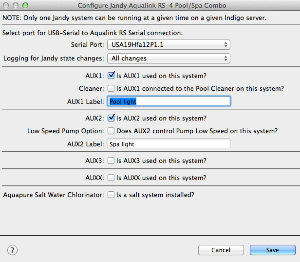

Edit Device Settings (example illustrated for RS-4 with two AUX labelled)
Serial Port: Select your serial port connected to the Jandy Aqualink-RS Serial Adaptor (e.g. USA19H47P1.1)
Logging for Jandy state changes: Select what level of logging you desire (see notes below)
AUX1 - AUXX: Select auxiliaries that are installed on your system. If a Pool Cleaner, Low Speed Pump, Waterfall or Solar Heater are installed on AUX1, AUX2, AUX3 or AUXX, respectively, select the corresponding checkbox. Add a label to be used in Triggers and Control Page pop-ups if desired. [Note that device states and actions will still refer to AUX by number.]
Aquapure Salt Water Chlorinator: Select if a salt water chlorinator is installed, to capture salt concentrations

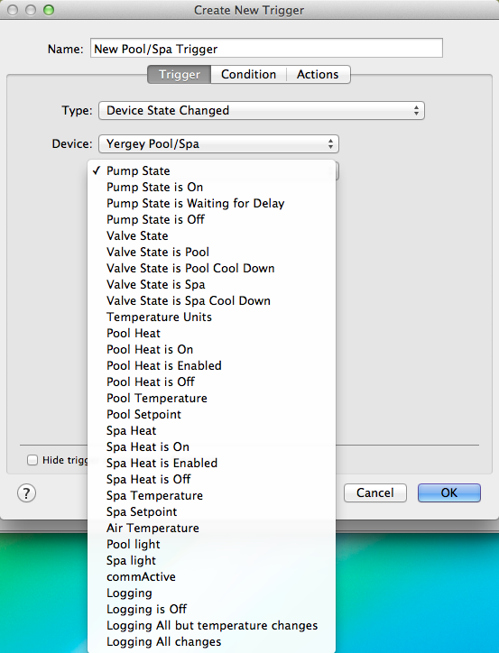

1) All of the above states are available in Triggers and Control Pages. Example of creating a new Trigger Action shown below.
2) The Jandy COSMSGS command is issued at startup to enable the Jandy system to update the device states in an ongoing manner. [For those who have used the Jandy Aqualink AppleScripts, note that this method of direct communication used by the plugin allows your Pool/Spa device to maintain up-to-date temperatures as well as valve, heater, etc. states without ongoing polling by the plugin.]
3) All temperatures are stored (as integers) in °F or °C, per units selected at the Jandy system
Example of creating a New Trigger Action:

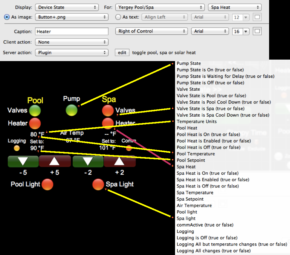

Example of a Control Page:
Notes:
1) All of the elements use the same "Display: Device Status For: Yergey Pool/Spa" and just select the appropriate state from the list.
2) For those that are linked to an action, the "Server action: Plugin" is used, and an action is created, as exemplified and highlighted for toggling the spa heater.
3) Red, yellow and green versions of a Button+.png file are used to differentiate various states (e.g. Button+off.png = red, Button+enabled.png = yellow and Button+on.png = green are used for the pool or spa heater states off, enabled and on, respectively). Button examples included with installation zip file.
4) The temperatures are presented as integers, and the units device state are aligned next to the temps.
5) Because COSMSGS is set on for communication, temperatures are updated in real-time, unlike with the older AppleScript implementation.

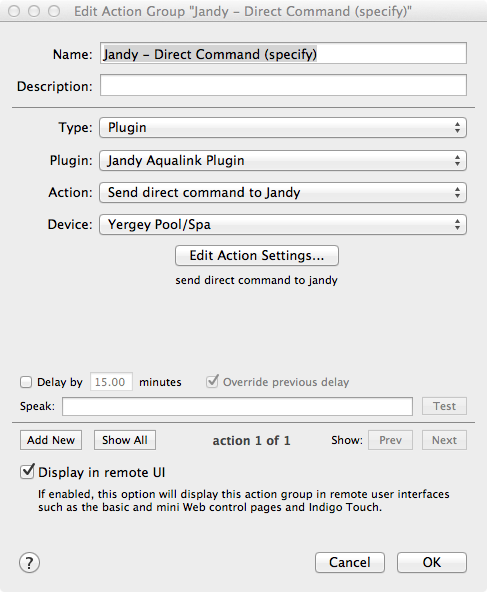

Example of creating a New Action Group:
05 - Create-Edit Send Direct Command to Jandy.png (68.39 KiB) Viewed 8919 times

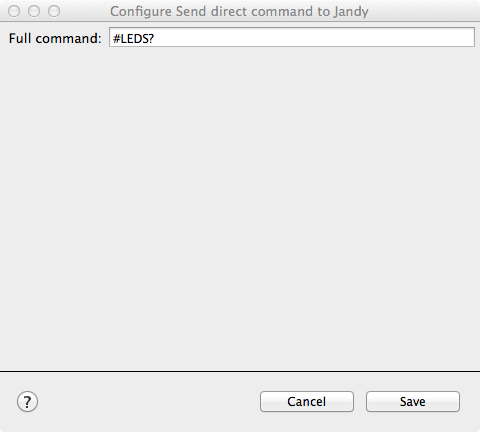

Example for "Send direct command to Jandy" Action, sending the "#LED?" command:
06 - Configure Send direct command to Jandy.png (22.72 KiB) Viewed 8919 times
