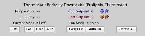

I am converting the Proliphix plugin to use a device type of thermostat instead of custom and have run into a problem. I am unable too get the DEVICES window to display any data for the thermostat. I know I am reading data and writing the inherited states. But, no display data.
Here is my thermostat object and the Indigo UI display:

berkinet wrote:I am unable too get the DEVICES window to display any data for the thermostat. I know I am reading data and writing the inherited states. But, no display data.
Hmm... the dump of the thermostat instance looks good. Some questions:
1) Does the Example Thermostat plugin work?
2) Copy/paste the exact .py lines you are using to change the main temperature input.
3) Are there any errors logged when you update states?

Ok... The example plugin works (and displays seemingly random temp values).
The plugin was throwing an minor error:
  • Error device state key temperatureInput2 not defined (ignoring update request)
    Error device state key temperatureInput3 not defined (ignoring update request)
Which I had just ignored for the time, but just now fixed. The reason for not dealing with it immediately is that I read from the physical device and write to the Indigo device in a two nested loops (outer iterates over the devices, and the inner iterates a list of OIDs). And, since you asked, here is where the loop writes to Indigo...
  • prDevice.updateStateOnServer(key=theOBJ, value=theOUT)
I am sure I am just missing setting something. But, for the moment I can't seem to find it. To that end, I diffed the example device "<" and my device ">" and get this:

I think the problem is you are passing strings and not floats (or integers) to the updateStateOnServer() method. The example plugin temperatureInput1 is type "real" but your temperatureInput1 is type "string."
So for your theOUT object, when it is a temperature/humidity/setpoint value, try casting it via float() before you call updateStateOnServer().
berkinet
Posts: 3441
Re: 5.0.3 Thermostat device type
Post by berkinet »
That was it. Now to the next step. The Proliphix data dictionary does not map directly to the pre-set elements you have defined for the UI. So, I need to do a bit of juggling. Also, this was the first plugin I wrote, and as I look at it now, it could use a "bit" of a re-write.
But, I am over the big hump and its downhill from here.
Thanks.

That is just the nature of how floating points are stored internally on computers. You can specify the precision you want when it is logged or converted to a string by using %.2f formatter, like:
tempStr = "%.2f" % (dev.temperatures[0],)
(or %.1f for tenths, or %.0f for integer precision)
berkinet
Posts: 3441
Re: Bug or?
Post by berkinet »
support wrote:...That is just the nature of how floating points are stored internally on computers. You can specify the precision you want when it is logged or converted to a string by using %.2f formatter
Well, maybe I am missing something here... But, I thought Indigo calculated the temperatures state object. All I am writing to is temperatureInput1, and I have set the updateStateOnServer to use decimalPlaces=1. Are you saying that decimalPlaces only affects the display and not the actual value stored in Indigo. Ok. I'll try that.
But, OTOH, from time to time I still see full precision numbers in the state column. Mostly when I restart the plugin, then they clear later on updates.
berkinet
Posts: 3441
Post by berkinet »
Well, if this is something I can control, I am missing it.
I now have this code in the plugin:
  • theOUT = round(float(theOUT), 1)
    prDevice.updateStateOnServer(key=theOBJ, value=theOUT, decimalPlaces=1)
Which sets these two states:
  • temperatureInput1 : 67.40000000000001 (real)
    temperatureInput2 : 70.5 (real)
From which Indigo derives:
  • temperatureInputsAll : 67.40000000000001, 70.5 (string)
    temperatures : [67.400000000000006, 70.5]
But, after letting a few minutes pass, I see these values:
  • temperatureInput1 : 66.8 (real)
    temperatureInput2 : 70.2 (real)
    temperatureInputsAll : 66.8, 70.2 (string)
    temperatures : [66.799999999999997, 70.200000000000003]
Seems flakey to me, but maybe its me that's flakey :?
matt (support)
Posts: 21542
Location: Texas
Post by matt (support) »
We need to document it, but the decimalPlaces arg is only supported for custom states not states inherited from Indigo. We might improve that at some point, but right now it is ignored for relay/dimmer/thermostat inherited states.
berkinet
Posts: 3441
Post by berkinet »
Gotcha.
On the same subject (more-or-less), I assume the syntax you used in the example:
  • dev.updateStateOnServer("setpointHeat", 66.5)
Is just a synonym for:
  • dev.updateStateOnServer(key="setpointHeat", value=66.5)
Or is something else implied?
