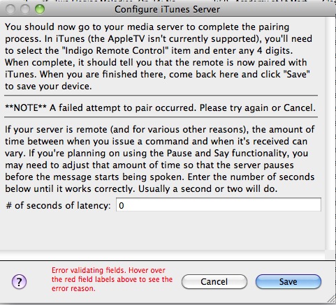

I am unable to pair the iTunes plugin with iTunes. I've tried with the suggested "0000" as well as another 4 digit number that I frequently use. iTunes reports that the remote <Indigo> is now able to control iTunes. However, the bottom of the "Configure" window says "Error validating fields. Hover over red fields..", but there are no red fields. There is this after the pairing instruction: **NOTE** A failed attempt to pair occurred.
FWIW, I always work in a non-admin account. This is the way I've worked since 10.0.0.
- Configure iTunes Server.jpg (106.71 KiB) Viewed 8998 times

Re: Can't pair an iTunes Plugin device with iTunes
The Indigo server is running in an admin account. The client is running in a non-admin account of the same Mac. Of course, both accounts have an iTunes server, but I don't use the one in my admin account.
I don't think bonjour can query a different account on the same Mac. I initially had difficulty connecting the Indigo client in my non-admin user account with the server in the admin account on the same Mac. I had to manually enter the server address as 127.0.0.1 to make the connection. The graphic below is a screen snapshot of some fseventer activity that was run during a paring attempt. "John" is my user account and "JTadmin" is my admin account.
- iTunes-Indigo pair attempt.jpg .jpg (76.46 KiB) Viewed 8930 times

Please let me know if I can provide additional info.
Just a few setup details:
-MacMini running admin account running Indigo 6.0.0b and intending to pair with iTunes (both on localhost)
-Ethernet port connected (no airport or anything else). IP is 192.168.39.143
-No VMWare or Parallels running. Crossover is installed but not running.
I made several attempts to connect which fail immediately after entering a 4 digit pin in iTunes. From the logs below, I'm getting an error stating: dacp.open: exception: (48, 'Address already in use')
