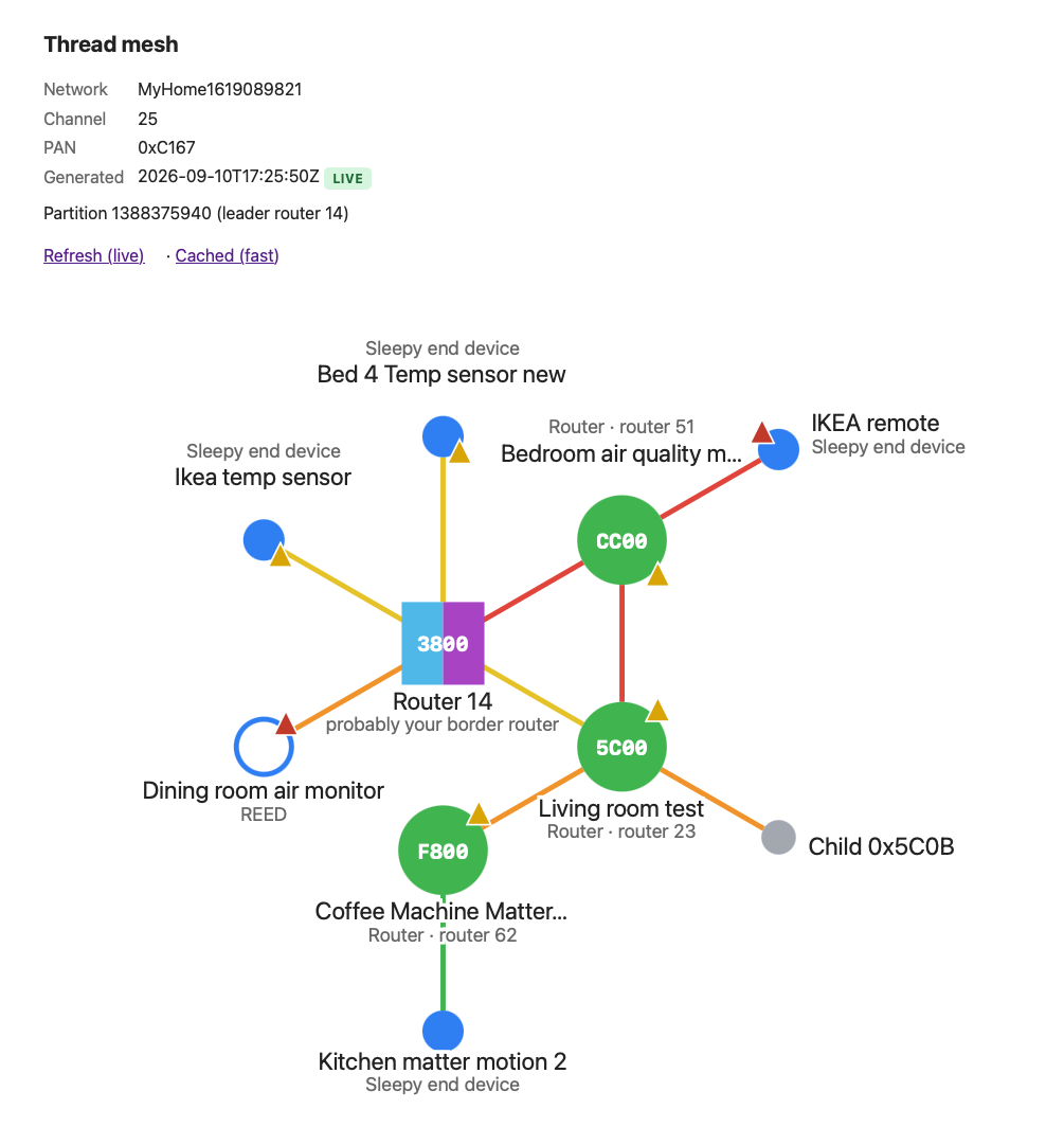

- A Thread mesh map page, served by the Indigo Web Server at
http://<your-indigo-host>:8176/message/com.simons-plugins.indigo-matter/thread
It draws the mesh as a tree: the leader at the top, every router below it, and every end device under whichever router it's parented to. Edges are coloured by signal strength and labelled with link quality and frame-error rate. Below the map is a list of health flags and a table of every node. It's a self-contained page with no JavaScript or external assets, so it reads fine on a phone over the Reflector.

Routers on your mesh that aren't Indigo devices (typically your HomePod or Apple TV border router) appear as "Router N", and the leader is captioned "probably your border router" when it's one of those. Everything here is read-only; nothing in this feature writes to a device.
Cached vs live, and how old the data is
By default the page shows what matter-server has cached, which is instant. Sleepy battery devices only report when they wake, so their cached picture can be hours old. To make that honest, every node shows when it was last interviewed (interviewed 6d ago) and, if the plugin has seen a live update from it since it last started, that too (last update 2h ago). Anything older than an hour is highlighted amber, and the header tells you the oldest reading on the fabric and how many nodes have none at all. A couple of fresh readings can't make the whole mesh look freshly surveyed.
Click "Refresh (live)" on the page (or tick the live-read box in the menu report) to read every sleepy device directly. Routers are mains-powered and continuously polled, so they're always current. A live read of a sleepy device has to wait for it to wake, so the pass can take up to a minute; a node napping longer than that shows as unreadable rather than holding everything else up. From the menu, the report follows in the Event Log within about a minute.

An example of the webpage showing details of the mesh.
