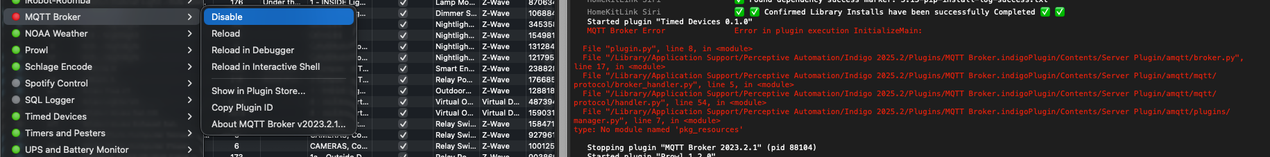

I downloaded the new 2025.2 Indigo and the MQTT plugin failed to load properly. I clicked around and did a reload or two to see if I did something wrong (that's usually the case), but I didn't see anything. Would you take a look and see if that plugin needs an update? or Most likely, that I've messed something up. Thank you, as always, for your efforts.

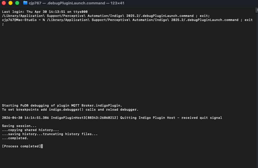

Ah. I'm sorry for not being clear. This is the MQTT Broker. I included a screen shot showing the red dot along with the log entries as it was starting up. I also selected reload in debugger and included that screen shot. To be thorough, I re-downloaded it from the plugin store, which asked for it be downgraded. Same results.

I can't read the log screenshot. Please copy and paste the text into a post.

Here goes. Sorry for it being unclear. And thank you for all your plugins-- You've added so much to Indigo. Incredible.
Apr 30, 2026 at 15:41:36
Reloading plugin "MQTT Broker 2023.2.1" using API v3.4
Starting plugin "MQTT Broker 2023.2.1" (pid 90404)
MQTT Broker Requirements Processing requirements for plugin "MQTT Broker 2023.2.1"
MQTT Broker Requirements Requirements previously processed, continuing startup
MQTT Broker Error Error in plugin execution InitializeMain:
File "plugin.py", line 8, in <module>
File "/Library/Application Support/Perceptive Automation/Indigo 2025.2/Plugins/MQTT Broker.indigoPlugin/Contents/Server Plugin/amqtt/broker.py", line 17, in <module>
File "/Library/Application Support/Perceptive Automation/Indigo 2025.2/Plugins/MQTT Broker.indigoPlugin/Contents/Server Plugin/amqtt/mqtt/protocol/broker_handler.py", line 5, in <module>
File "/Library/Application Support/Perceptive Automation/Indigo 2025.2/Plugins/MQTT Broker.indigoPlugin/Contents/Server Plugin/amqtt/mqtt/protocol/handler.py", line 54, in <module>
File "/Library/Application Support/Perceptive Automation/Indigo 2025.2/Plugins/MQTT Broker.indigoPlugin/Contents/Server Plugin/amqtt/plugins/manager.py", line 7, in <module>
type: No module named 'pkg_resources'
Stopping plugin "MQTT Broker 2023.2.1" (pid 90404)
Stopped plugin "MQTT Broker 2023.2.1"
