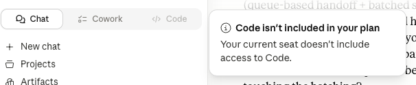

Aw man.. been meaning to look into these for a while.. finally got around to it and realised it's all Claude Code stuff which unfortunately the admin on my enterprise account has disabled access to for some reason :(
siclark
Posts: 2355
Location: UK
Re: The Indigo Claude plugin
Post by siclark »
What do you have?
durosity
Posts: 4810
Post by durosity »
siclark wrote: Wed May 20, 2026 8:16 am What do you have?
Just the normal Claude.
I'm not sure why they turned it off, it was available a few months ago.. but I guess they had a good reason to do so. Still I can do my usual work with the 'chat' functionality.
