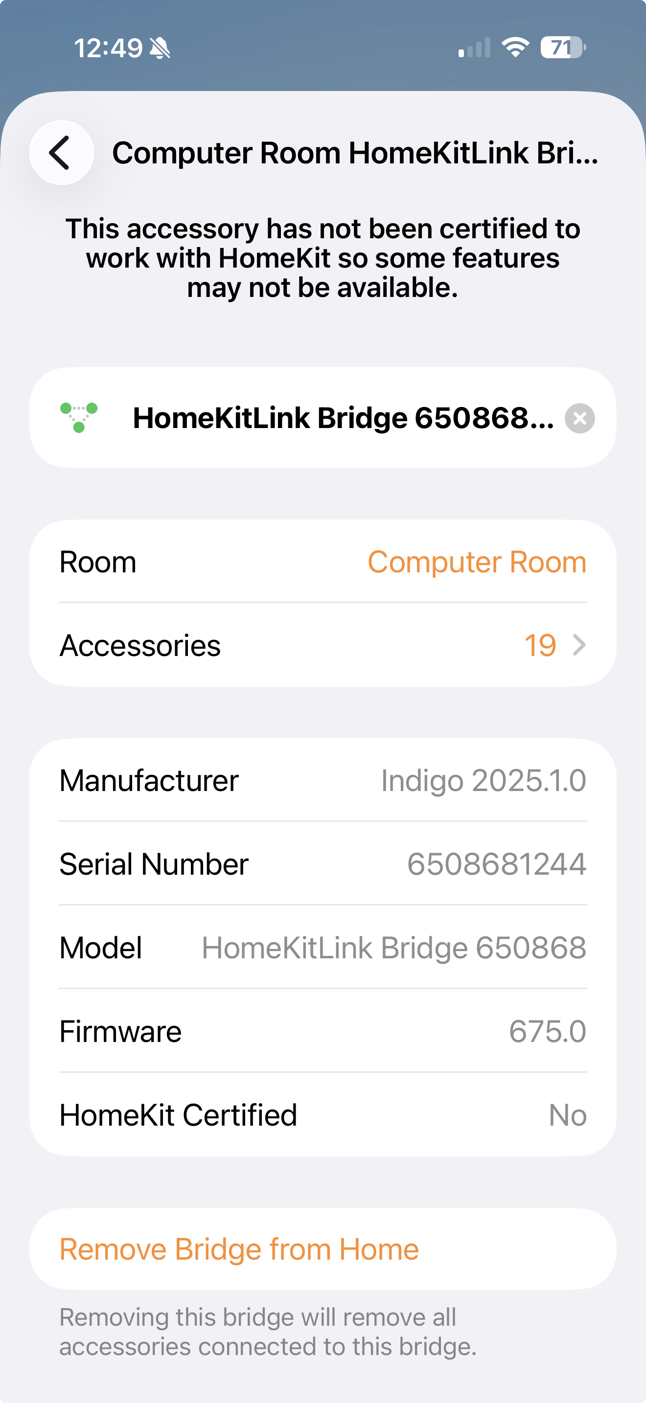

All things being "normal", I suspect this is related to the changes to HomeKit that Apple recently made.
I posted the work around to the tvOS 26.4 beta issue that came up, there was a separate issue with a previous beta of macOS 26.4 that stopped registering mDNS for the HomeKitLink-Siri Indigo Plugin (current beta works now). But, now I'm getting this message now ("This accessory has not been certified to work with HomeKit so some features may not be available") in my Home app, when just two days ago everything was working fine after my work-around.
All of the 19 accessories are stuck on "Updating..." and then on the Home home page, "No response".
