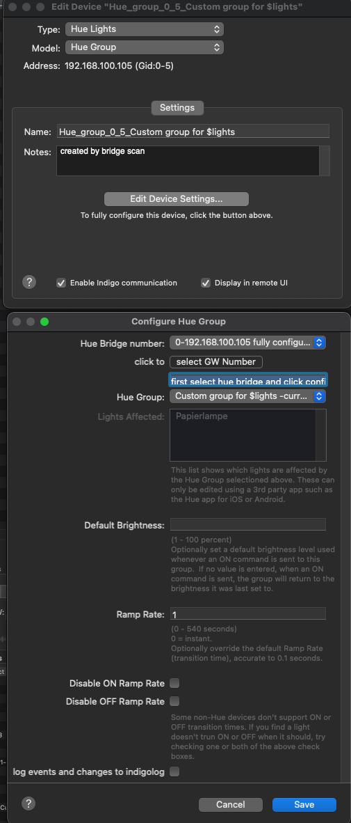

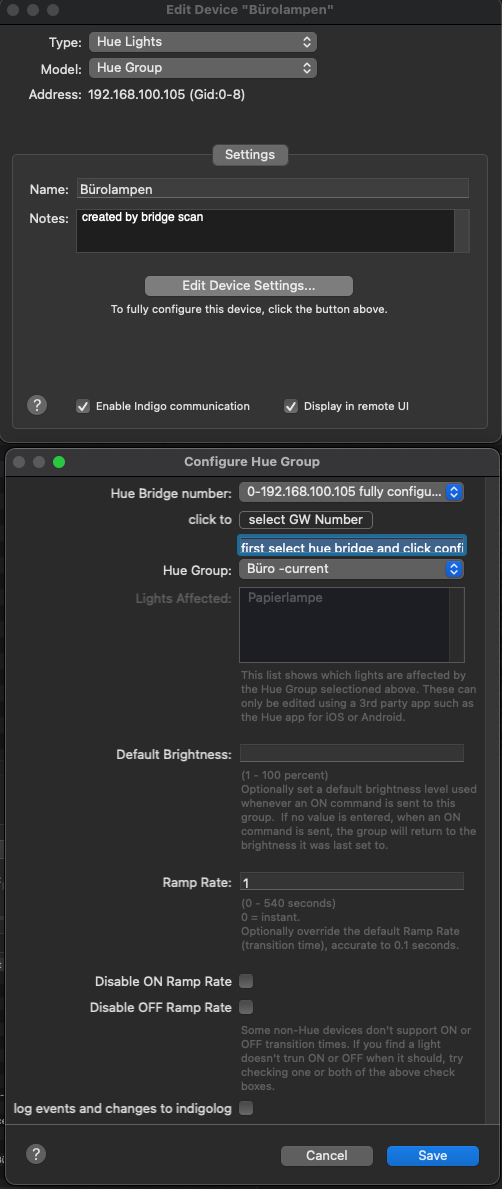

I have an issue here with a lamp which appears in two Hue groups.
One of the groups, called "Bürolampen" (ID:8) is allocated to a room "Büro" (Office) and the lamp ("Papierlampe") ist in that room. All good.
However, I a have an unused group (ID: 5) which is not allocated to a room and the lamp appears in that group as well and can't be removed from the group.
Deleting the group isn't possible, because it will be recreated automatically when reading the bridge config.
How-to solve this?
I want to have the lamp only in the correct room and not in the unallocated group as well.

======================= print Hue Groups =====================
==  Bridge: 0, ipNumber: 192.168.100.105, hostId: <placeholder>, #of Groups: 9, paired: True, sortedby: id
 ID Name------------------------- Name------- Lights---------------------------- IndigoDevName------
  1 Wohnzimmer                    Room        1,16,17,2,21,4                     Wohnzimmerlampen
  2 Küche                         Room        20                                 Küchenlampen
  3 Flur                          Room        3                                  Flurlampen
  4 Schlafzimmer                  Room        18,19                              Schlafzimmerlampen
  5 Custom group for $lights      LightGroup  5                                  Hue_group_0_5_Custom group for $lights
  6 Gästebad                      Room                                           Gästebadlampen
  7 Spielzimmer                   Room        6,7                                Kreuzlampen
  8 Büro                          Room        5                                  Bürolampen
  9 Bad                           Room                                           Badlampen

The plugin copies whatever is on the hue bridge. If there are 2 groups it will also create 2 groups. But you can switch off auto create

kw123 wrote: Fri Nov 29, 2024 10:48 am The plugin copies whatever is on the hue bridge. If there are 2 groups it will also create 2 groups. But you can switch off auto create
OK, thanks. That's clear.
But then, it's a hub issue and not an Indigo one, right?
