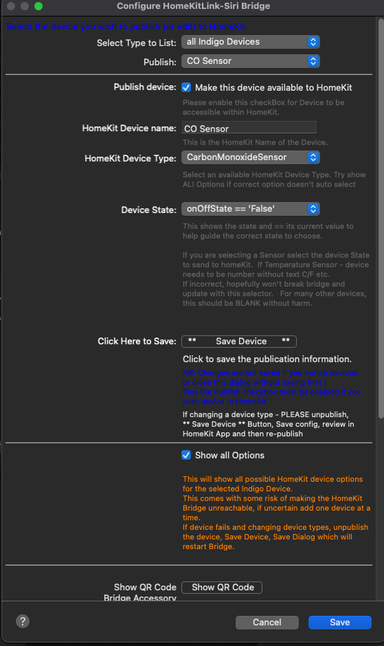

I'm trying to add the Fibaro CO sensor (FGCD-001) to HomeKit.
However, after saving the device and AFTER saving the second time (at the bottom of the config window) I'm getting the attached errors and the plugin remains in "starting up" mode.
Only if I remove (unpublish) the device again the plugin will run correctly.
Any ideas what is causing the errors?

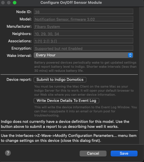

Could it be possible, the errors appear because the device isn't properly synced?
It appears as "Notification sensor" and not as the device itself.
Even the sync screen says, it does not have a device definion for it. But according to the supported hardware list it should.

Certainly if is has no definition within Indigo - then the needed states likely wont exist - that is confirmed in image you have posted saying that device definition does not exist within Indigo.
It would remain possible that the item is supported, just an updated model ID for different area etc. is needed. Unfortunately that still is a new Indigo release away…

It looks like Fibaro changed the Z-Wave model ID without changing the part number. We'll look at adding support in the next feature release.
