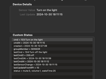

This is how the dev states look like.
It shows the current command text in sensor ui value, the sensor value is 103; last commands; when they happened; config in status etc
Screenshot 2024-10-30 at 18.15.25.png (37.5 KiB) Viewed 951 times

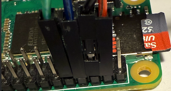

how to connect: i2c:
Screenshot 2024-11-08 at 10.18.22.png (191.45 KiB) Viewed 805 times

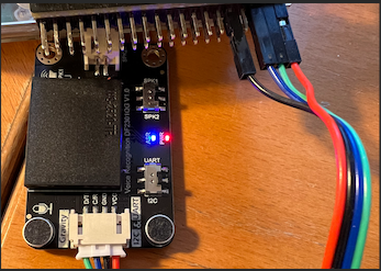

serial:
Screenshot 2025-01-11 at 23.24.02.png (142.09 KiB) Viewed 366 times

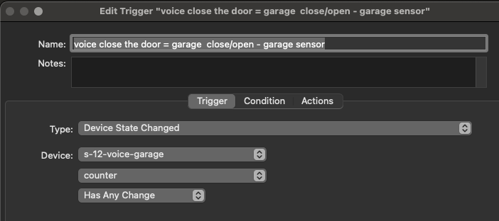

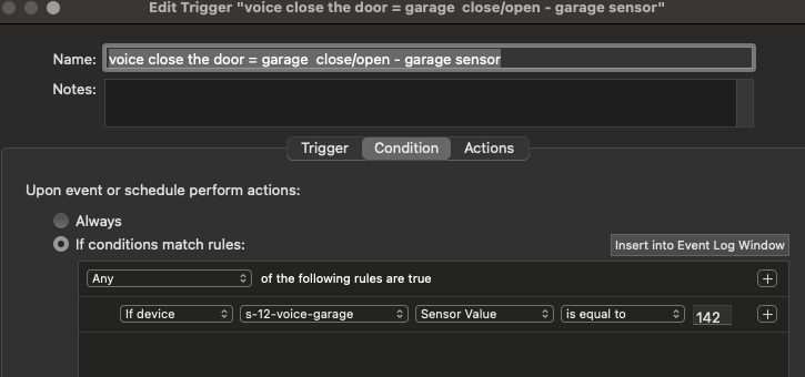

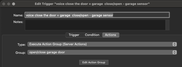

example for trigger to close garage door:
Screenshot 2024-12-23 at 13.38.13.png (33.23 KiB) Viewed 437 times
