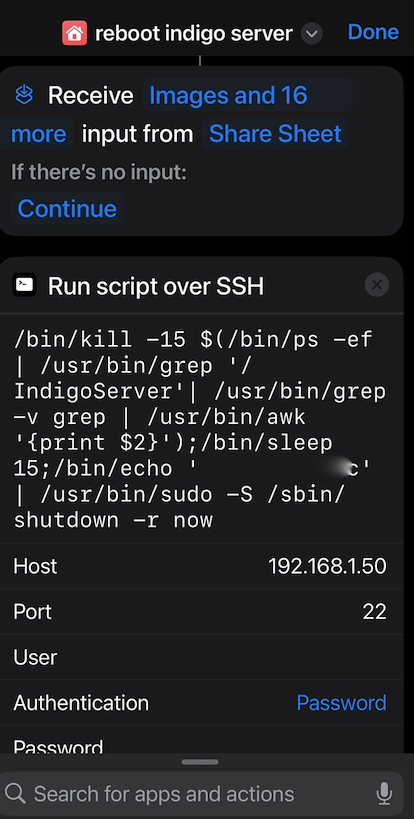

and as a one-liner in a shell
/bin/kill -15 $(/bin/ps -ef | /usr/bin/grep "/IndigoServer" | /usr/bin/grep -v grep | /usr/bin/awk '{print $2}');/bin/sleep 15;/bin/echo 'yourpasswordhere' | /usr/bin/sudo -S /sbin/shutdown -r now
that will gracefully shutdown the indigo server app and then (after 15 secs) do a reboot
Re: reboot indigo server (the whole MAC), an action script
tried that one liner also in an iPhone shortcut and it works:
naturally you need to put in your users and passwords and ip number of your mac in the proper areas.
if not in your local network, start a vpn sessions first.
