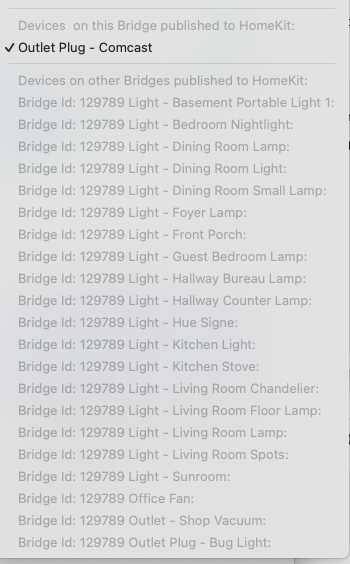

However, another issue, the devices published on the previous bridge are shown in HKLS as unavailable. How can I completely eliminate the old bridge and begin adding those devices to the new one?
I think I mentioned, I completed deleted the entire Home from HomeKit and started fresh there, so no old bridges were in there up until just now – the new one. So this would seem like something leftover in Indigo? I also did a system restart.

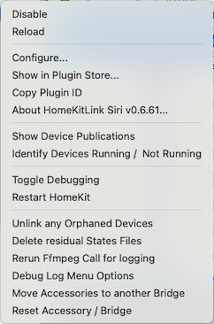

GlennNZ
Posts: 1873
Re: HomeKitLink Siri Start from Scratch?
Post by GlennNZ »
Hi
Couple of options - listed there into the PluginOptions Menu you have pasted
The one you want will be:
Unlink any Orphaned Devices
Will remove any devices linkage with bridge you may have inadvertently removed before you could unpublish device
makedrinklas
Posts: 170
Joined: Tue Oct 12, 2004 11:29 am
Post by makedrinklas »
Yep, that worked. Thank you!
