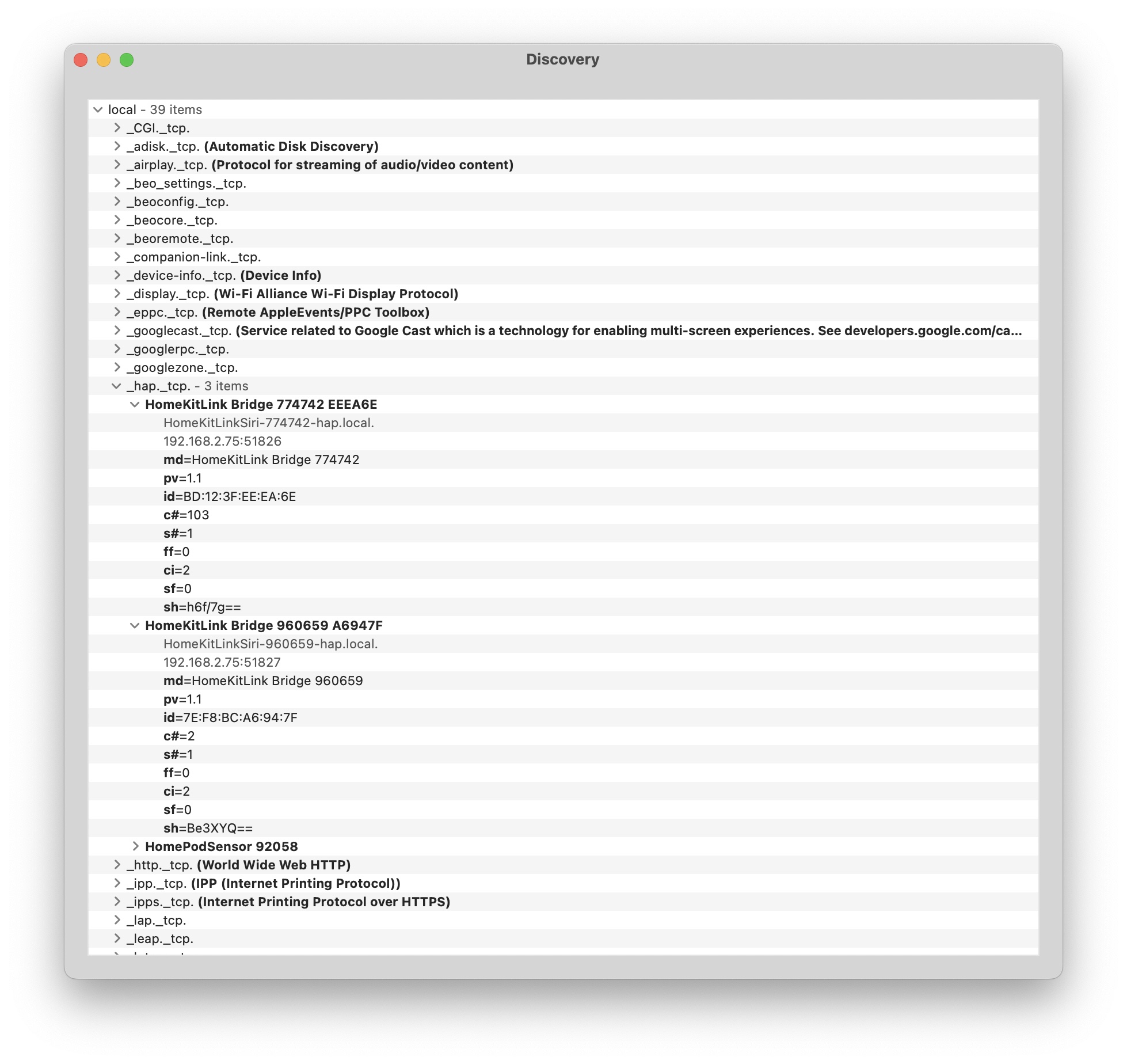

3. See the troubleshooting page - can try the discovery app (free) and see if can see the HomeKitLink instance. If can’t see it - is Mac/Firewall/Network settings somewhere.
I ran the Discovery app and I can see the original HomeKitLink instance (Bridge), as well as the new Bridge I added. Attached screenshot

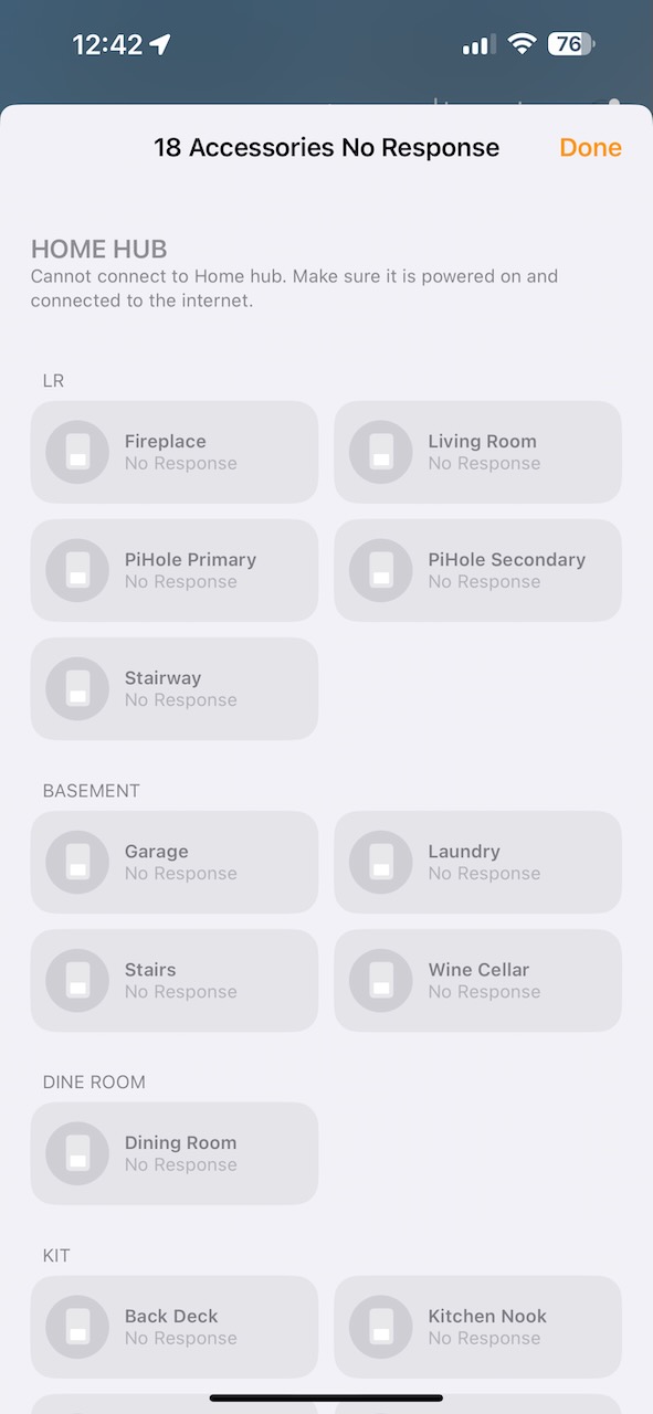

I created the new bridge, added an Indigo light switch device to it, and added the bridge to the Home app. The light switch appears, but it is the same problem "No Response".

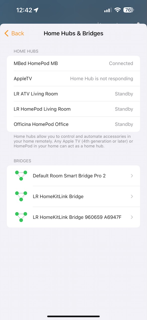

One extra note (see screenshots). The Home app will say "Cannot connect to Home hub" on one screen, but on another screen it will show connected to one of many Home hubs I have (2 Apple TVs, and 3 HomePods). So a little perplexed.

At that moment, I had an Apple TV and 2 HomePods acting as Hubs as seen in the Home app. The HomePods for some reason both said not responding, and the Apple TV said it was connected.
I removed the Apple TV from the Home App, which forced it to start using one of the HomePods. Then all my devices came back.
