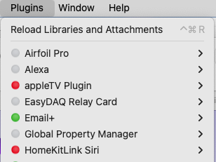

New system, first install of this plugin. Installation fails with:
Starting plugin "HomeKitLink Siri 0.6.61" (pid 93331)
   Processing requirements for plugin "HomeKitLink Siri 0.6.61"
   Requirements installing, this may take a few seconds...
Screenshot 2024-02-11 at 11.36.58.png (24.87 KiB) Viewed 2437 times
