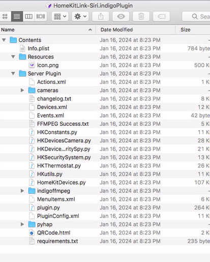

Screenshot 2024-01-25 at 7.34.12 PM.png (272.5 KiB) Viewed 1976 times
I'm not in a rush with this plugin... But I don't have a packages folder under contents. Also, under logs, there isn't a seperate folder for this plugin. Never looked before, so I don't know if that is normal or not.
