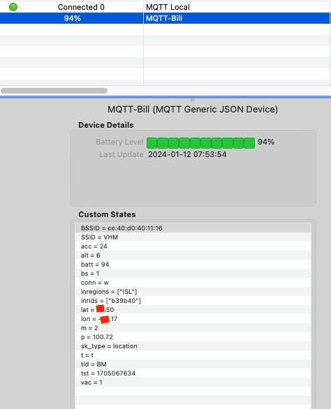

And this is what the device looks like so far:
Screenshot 2024-01-12 at 7.55.36 AM.png (36.18 KiB) Viewed 2581 times

Take the "End" term out of the trigger. I think the device sends additional topics you might want to capture.
I'll need to look at the code to see what's going on with the lat/long values. The JSON payload has the full values. I might have a bug in the plugin when storing that data to the states.
Re: Request assist with first MQTT project.
Oops. My bad. I'm actually truncating floats to 2 decimal places in the states. Not sure why I did that. I'll roll a fix for that today.
