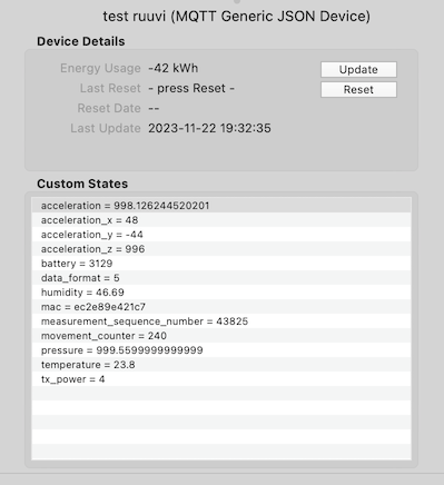

Ok. Took a while because of problems getting the right message matching. Now, the packets seem to be fed to the decoder. And I have a different problem. My decoder assumed it would only receive the specific encoded payload item. However, I now realize you are simply feeding the entire payload to the decoder, and it is my job to dig out the one item I want. So, a little work here. But, so far it looks really good. Thanks.!
Re: Processing encoded payload data
Should just be payload['data'] to get the part you wanted.
berkinet
Posts: 3441
Post by berkinet »
FlyingDiver wrote:Should just be payload['data'] to get the part you wanted.
And, voila...
Screen Shot 2023-11-22 at 19.32.35.png (55.38 KiB) Viewed 1859 times
Thank you. This is perfect. Hopefully, others can benefit from this as well.

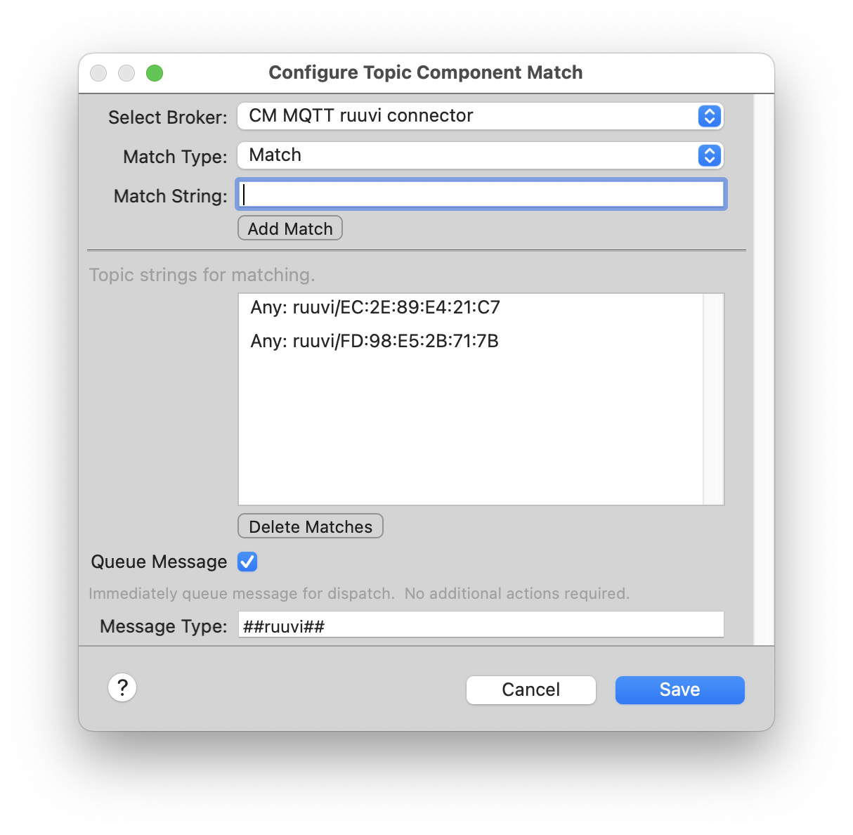

... and, a new wrinkle. At the current message rate, ~2 per second, the queue is getting backed up and throwing errors in the indigo log. Eg:
   MQTT Connector Warning          Queue for message type '##ruuvi##' has 86 messages pending
The way this is setup at the moment I have one trigger that reads the message queue from an MQTT connector device that only looks for Ruuvi messages, and then 2 shims. I suppose I could simply enable/disable the trigger so that it only ran once a minute or so. Or set/reset a variable to use as a condition in the trigger (same effect). But, is there a better way?
The only way that would happen is if the Shims processing is taking much longer than it should. First, restart the connector plugin (but not the Shims plugin) and see how long it takes for the errors to start appearing.
Second, post the code for your Decoder so I can see if something there is taking a long time.

Another bit of info. Opening a shim device for editing now hangs for at least a minute, maybe longer. Restarting the server makes no difference.
And, last, here is a picture of the trigger.
