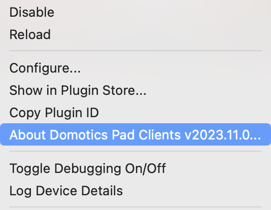

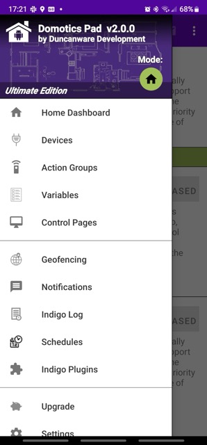

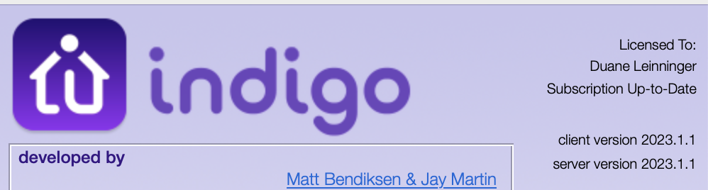

Thanks for your help. I'm using Indigo 2023.1.1, Domotics pad clients 2023.11.0(ish) and Domotics Pad v2.0.0.
Indigo version
Indigo version
Screenshot 2024-01-03 at 5.19.25 PM.png (198.85 KiB) Viewed 4809 times
Domotics Pad Clients version

Domotics Pad version
Screenshot_20240103_172107_Domotics Pad Medium.jpg (37.58 KiB) Viewed 4809 times
